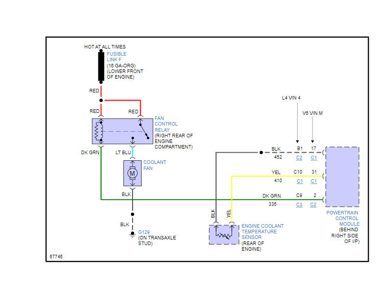

Hello, I am baffled why my cooling fan will not come on still. I replaced fan motor because it was bad.Replaced thermostat with new one. Did a test on my fan relay and it was bad, so I replaced it with brand new one. Just replaced the cooling temperature sensor with a new one. Fan will not come on ever, even when I turn a/c on. Car gets hot when idling because fan is not working. Please help, this is driving me nuts, Thank-you

There is fusible link that goes bad when the fan motor goes out here is the fan wiring diagrams so you can check it out and see how the system works. This guide can help you check for power. The fan is run by the cars engine computer.
Check out the images (Below). Please let us know what happens.

PCM you mean the cars computer? I can read the diagram so I repaired the link and now it works. Thanks for the reply
