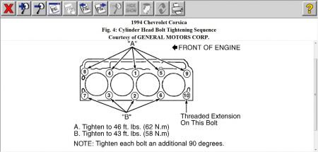

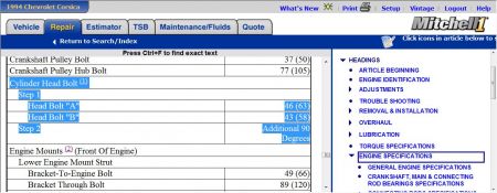

Engine Mechanical problem
1994 Chevy Corsica 4 cyl Two Wheel Drive Automatic
I will be changing the head gasket and I need to know what's the sequence used on the head bolts and the torque. I appreciate any assistance with that.

https://www.2carpros.com/forum/automotive_pictures/12900_cy1_1.jpg
https://www.2carpros.com/forum/automotive_pictures/12900_cy2_1.jpg
