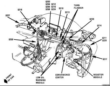

i cannot locate the flasher so i can replace it///i need a picture...a clear one

Hello - Here is the info your requested There isn't any pic of the hazard warning flasher. My suggestion is purchase it, look in the area it says and you should see the like item. The fuse panel is located behind the left-hand side of the instrument panel, near the shroud. The hazard warning flasher is located behind the left-hand side of the instrument panel in the convenience center. The turn signal flasher is located next to the convenience center.
https://images.2carpros.com/forum/automotive_pictures/248015_Flasher_1.jpg
