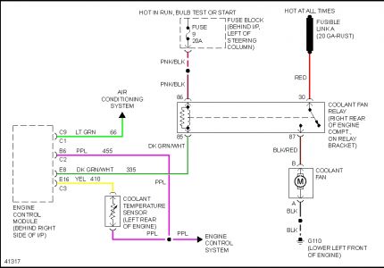

why isn't the fan kicking on and the engine gets hot and what is the hot and ground wire colors and where can i get a wire diagram for a 1993 corisca. thank you

well first off check the fuse and the cooling fan relay. . the cooling fan's wiring circuit is below..
