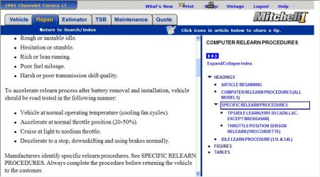

1993 Chevy Corsica 6 cyl Automatic 159000 miles
the other day my car didnt want to start so i was gonna replace the battery.. well after i took the battery out i discovered it wasnt the battery and my starter was not rollin over so i got it going and am going to replace that.. well now my car is not idleing right and kinda surges like its going to stall when foots not on gas.. when i turn put my foot on the brake then reaply it to the gas it kinda jerks a few times.. when i start it, it will occasionally rev up. I guess what im asking is this problem connected to my starter?? or just a Coincidence?? what could it be??
Apr 6, 2008 at 1:43 PM
  • 75,992 POSTS
It probably needs an idle relearning see below
https://images.2carpros.com/forum/automotive_pictures/12900_relearn_1.jpg
