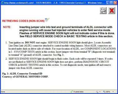

The ABS light went on and I drove it for 30 minutes on the interstate and the speedometer started going crazy and the vehicle died? What should I focus on when I take it in the shop.

First of all thank you so much for your donation.I posted how to get your trouble code's.So when the car died were you able to turn the engine over to try to start it?Or did it act like the battery was dead?The more detail's the better i can help you.
