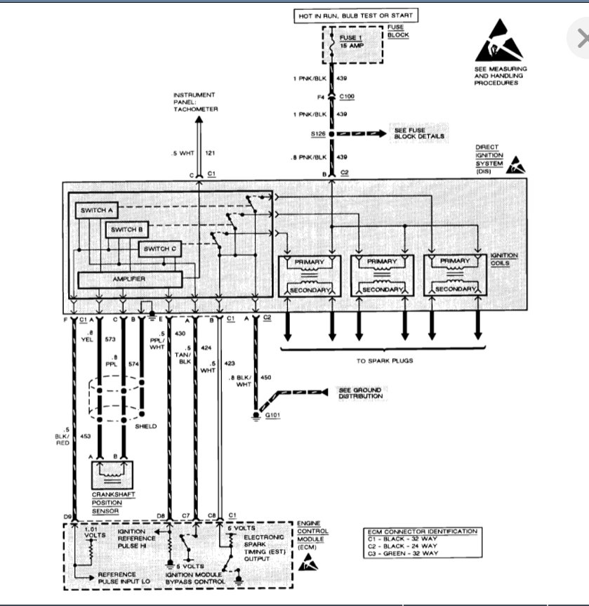

Okay, now i changed new spark plugs six spark plugs and i checked, but now i don't have any spark on the spark! The car still won't start and i don't know what happened the last time they had some spark on the spark. i try to remove the crank sensor but it stuck so hard i couldn't remove it.
Feb 17, 2022 at 8:32 PM
That is strange because if all you did was change the plugs then that shouldn't affect this. However, the place to start is from the beginning so let's check the fuse and just make sure you have a good fuse and power on both sides of it.
Here is a guide that will help with this:
Then go to the DIS and start checking voltage from the ECM. Clearly the crank sensor is the likely cause, but we could have other issues.
However, the most likely thing is the fuse blew so let me know what you find. I attached the wiring diagram below.
Feb 18, 2022 at 2:44 AM

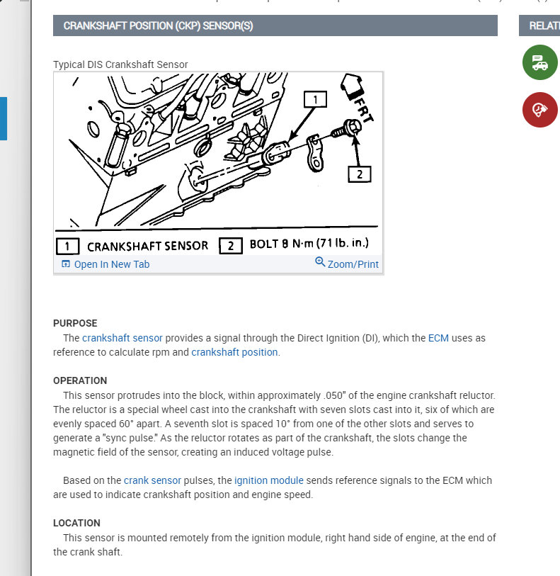

i check the fuse all fine. i think its crank sensor because it looks so bad and looks so bad and with a lot of oil and it look so old like I didn't replace it for 20 years.
Feb 18, 2022 at 5:47 PM
Sounds like a plan. I attached the info from the manual on this.
