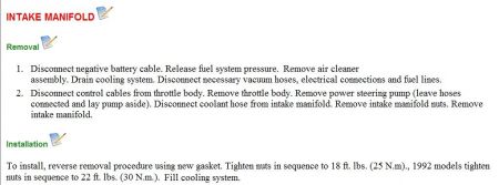

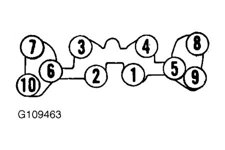

there is a box attatched to the manifold through which the control cables for the TBI pass. It blocks access to one of the bolts. How do I remove or get around this?

https://images.2carpros.com/forum/automotive_pictures/261618_Noname_2830.jpg
https://images.2carpros.com/forum/automotive_pictures/261618_Graphic_750.jpg
