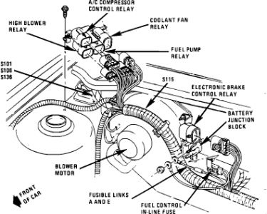

1991 Chevy Corsica RADAITOR RELAY SWITCH
1991 CHEVROLET CORSICA
138,000 MILES • 6 CYL • 2WD • AUTOMATIC
MIZELL50
HOW TO FIND RADAITOR RELAY SWITCH
Jan 8, 2010 at 9:00 AM
  • 75,992 POSTS
https://images.2carpros.com/forum/automotive_pictures/12900_radiatorrelay1_1.gif
Rear Of Engine Compartment, On Relay Bracket

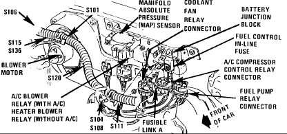

https://images.2carpros.com/forum/automotive_pictures/12900_radiatorrelay2_1.jpg
