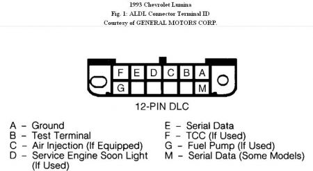

Hi tcambler, Thank you for the donation. Replacing things without understanding if that is the cause can be costly without rectifying the problem. I would suggest retrieiving for trouble codes first. RETRIEVING CODES (NON-SCAN) 1.Turn ignition on. DO NOT start engine. SERVICE ENGINE SOON light should glow. Locate Assembly Line Data Link (ALDL) connector attached to control module wiring harness. Most ALDL connectors are located under dash on driver's side of vehicle. For exact location of ALDL, refer to appropriate COMPONENT LOCATIONS illustration in article SYSTEM/COMPONENT TESTS in this section. Turn ignition on with engine not running. Insert jumper wire from terminal "B" (diagnostic test terminal) to terminal "A" (ground) of ALDL connector. See Fig. 1 .
https://images.2carpros.com/forum/automotive_pictures/192750_ALDL93LuminaFig01_2.jpg
2.SERVICE ENGINE SOON light should begin to flash codes. Each code will be repeated 3 times. To exit diagnostic mode, turn ignition off and remove jumper wire from ALDL connector. READING TROUBLE CODES Example, FLASH, FLASH, pause, FLASH, longer pause, identifies Code 21. The first series of flashes are the first digit of trouble code. The second series of flashes are the second digit of trouble code. Trouble codes are displayed starting with the lowest numbered code. Each code is displayed 3 times. Codes will continue to repeat as long as ALDL test terminal is grounded.

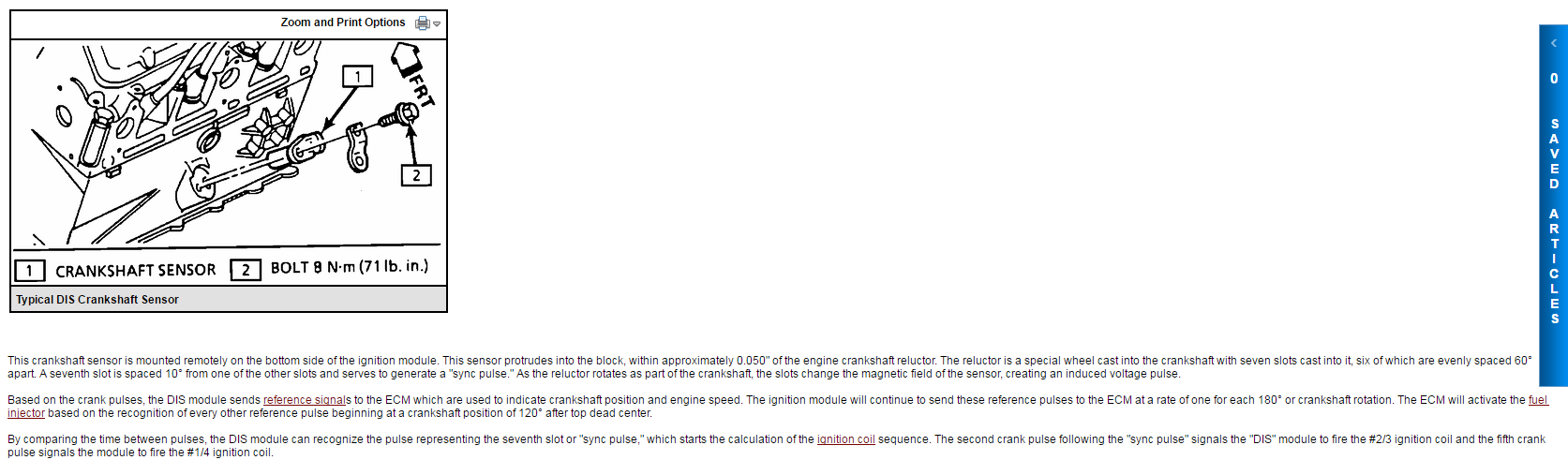

I need to know where the crank shaft sensor is located. Searched all day and cannot find it on this engine.

LOU P
  • 118 POSTS
here is the location. hope this helps. Lou .

what motor??????????

IRONMAN1959
  • 12 POSTS
I have a 1990 2.2L 4 cylinder and it appears that the sensor is on the firewall side below the intake manifold. This is what I found online, I looked there and I see a couple of wires going that way but is almost impossible to see without removing the intake manifold. And the intake manifold is almost impossible to remove without removing the head, (I know because I recently had my head off), so if it's a 2.2 good luck, if it's a 3.1 google it.
