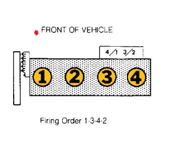

Could you please tell me what the firing order for a 1990 chevrolet corsica 2.2 L engine is??

hope that will help
https://images.2carpros.com/forum/automotive_pictures/99387_chevy22_1.jpg
