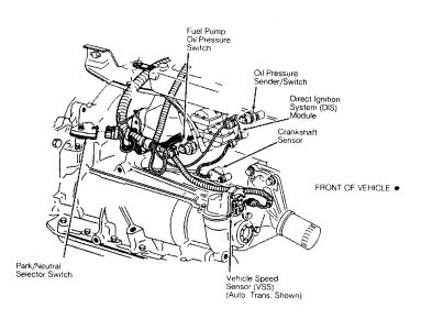

Need to check Crankshaft sensor to locate see diagram
https://www.2carpros.com/forum/automotive_pictures/198357_Graphic_550.jpg
Check connector for any moisture ie. from coolant leak. if good with OHM meter measure resistence across terminals 900-1200 OHMS. Next set meter on 2 V AC scale leads on terminals to sensor crank must be.1 volt or higher. if either fail replace sensor. If have NOID light think you can get to # 6 INJ. hook up see if it flashes when it dies.

In my case the crank sensor is between the engine and the transmission. With the car on jack stands I have extremely limited access to the unit and cannot line up my Fluke probes to get an ohm reading. I did punch into the wires and with the ignition on the voltage reads 0.035.

Follow sensor wire up to connector unplug make readings there. Also sensor needs to be unpluged and engine cranking to make voltage reading.

Crank sensor was cracked - replaced.

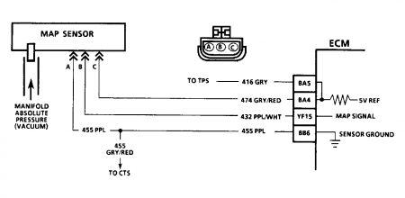

You could OHM injectors 12 ohms. Need to know what is lost at time of shut down Is threre fuel pressure? is there spark? Have to determine what is shuting down fuel or spark. Is code 34 still there?
https://www.2carpros.com/forum/automotive_pictures/198357_Graphic_597.jpg
