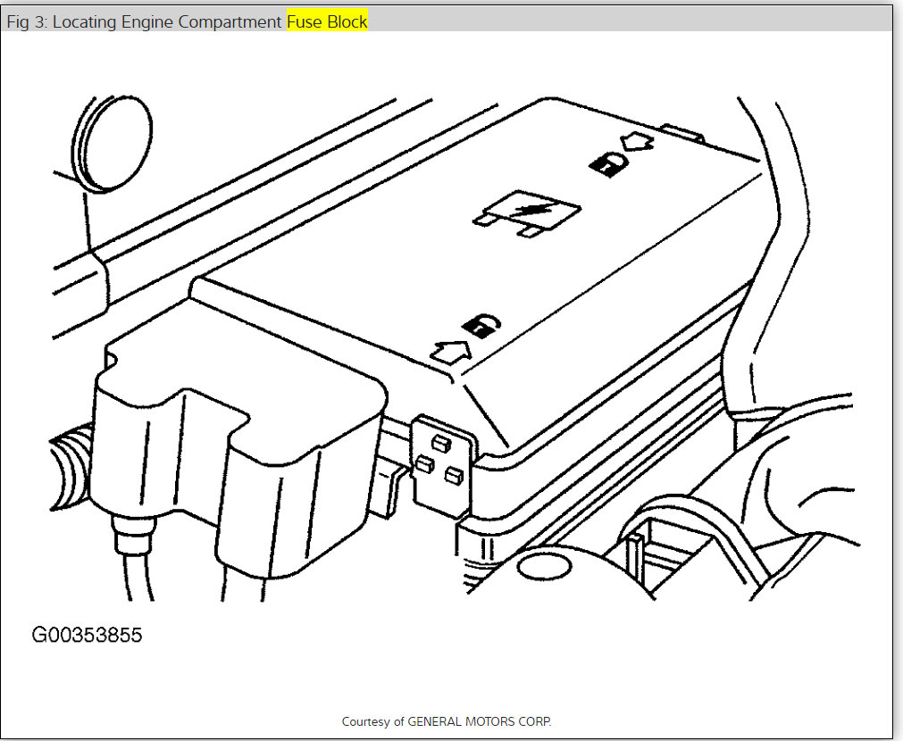

dash lights went out...got an abs error on the dash...truck won't start now...turn switch and nothing happens except an yellow engine symbol on the dash...no power at all to the starter...headlights work...no dash lights...dome light works...battery is fully charged...cables are fine...fuses and relays are fine.

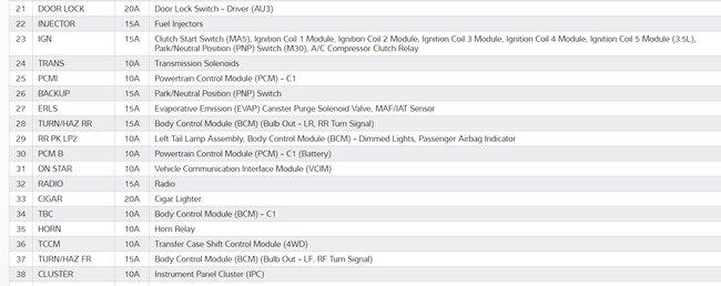

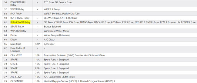

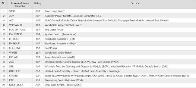

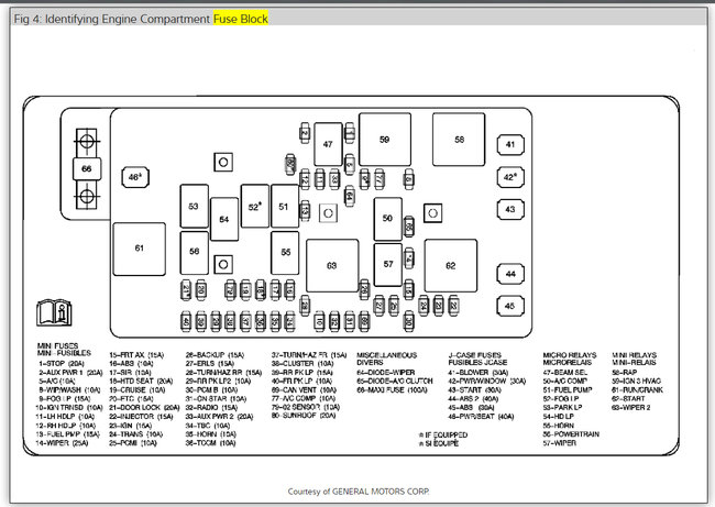

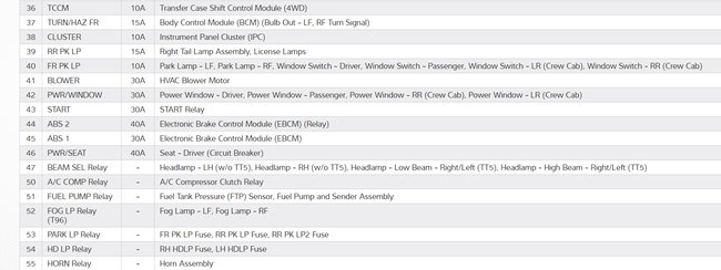

There is a powertrain relay in the under hood fuse panel that needs to be checked here is a guide and the location of the relay so you can test it.
Check out the diagrams (Below). Please let us know what you find. We are interested to see what it is.
