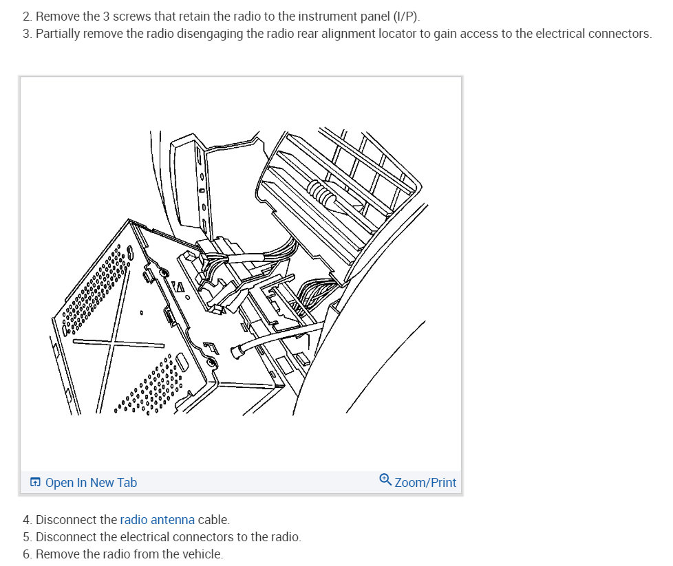

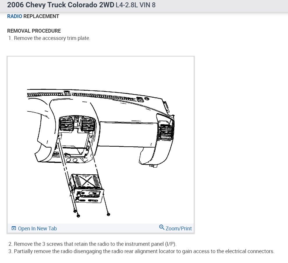

I live in Dallas/Fort Worth metroplex. I recently purchased this truck and noticed that the radio fades (both FM and AM) on local channels. Needless to say it is absolutely worthless on out of town trips. How do I check it out? What steps do I need to take?

Is that the same on the 2007 Colorado? I wasn't sure if it was my antenna or the stock stereo? What I am able to tune in sounds horrible.

Does it sound okay through the USB? Just the radio sounds bad? Can you please shoot a quick video with your phone so we can see what's going on, that would be great. You can upload it here with your response.

TIZMESHELL
It doesn't have an auxiliary jack so I'm using a converter for Bluetooth or my iPod.. Which sound great. The radio has always sounded terrible. Even before adding the converter. If you still need a video I'll get one a little later today.

A video will help, but it sounds like the speakers or the head unit are bad. If I had the video I can tell which. Here is a video of the head unit being installed on a similar vehicle with diagrams below to show you how on your car:
