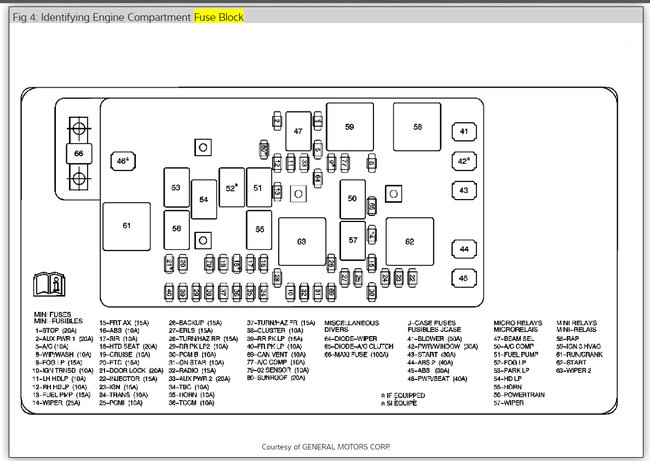

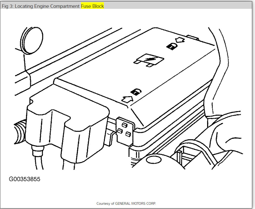

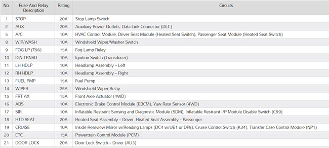

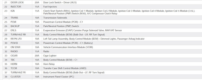

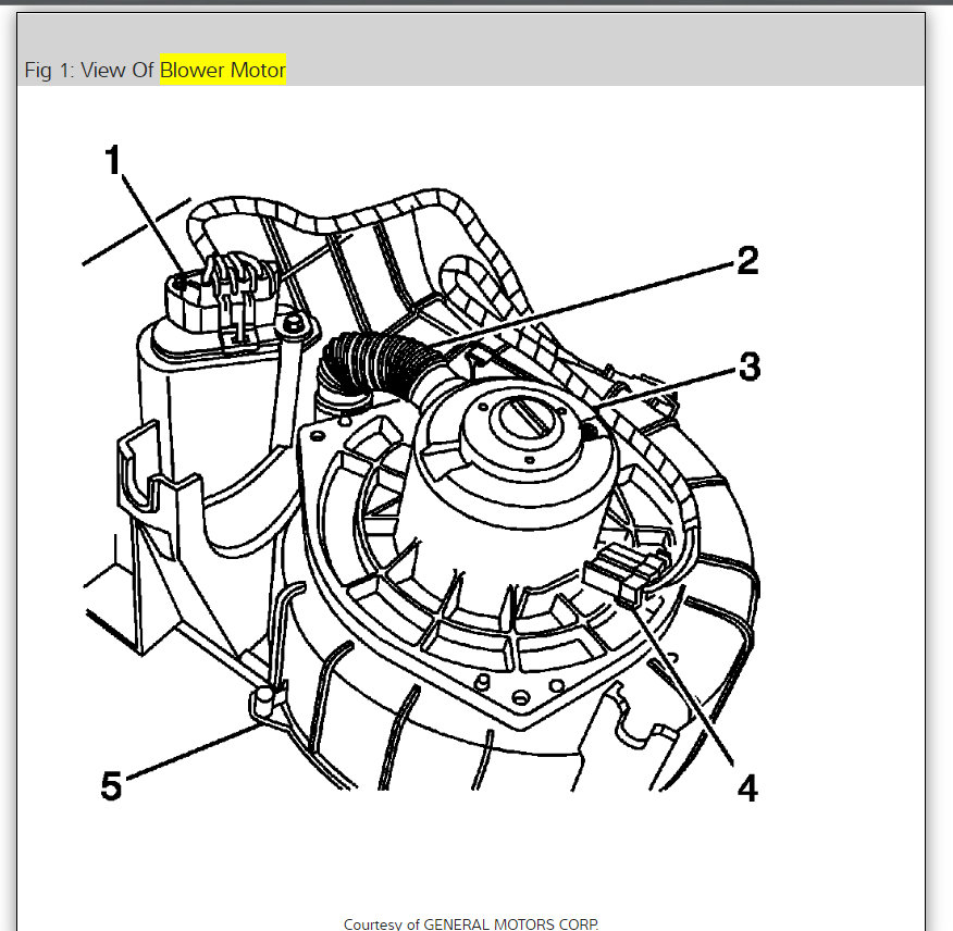

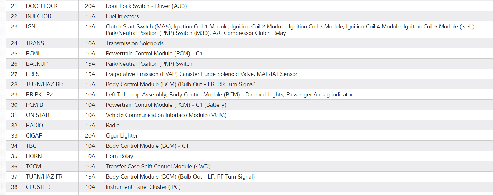

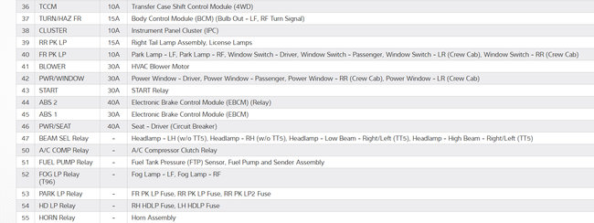

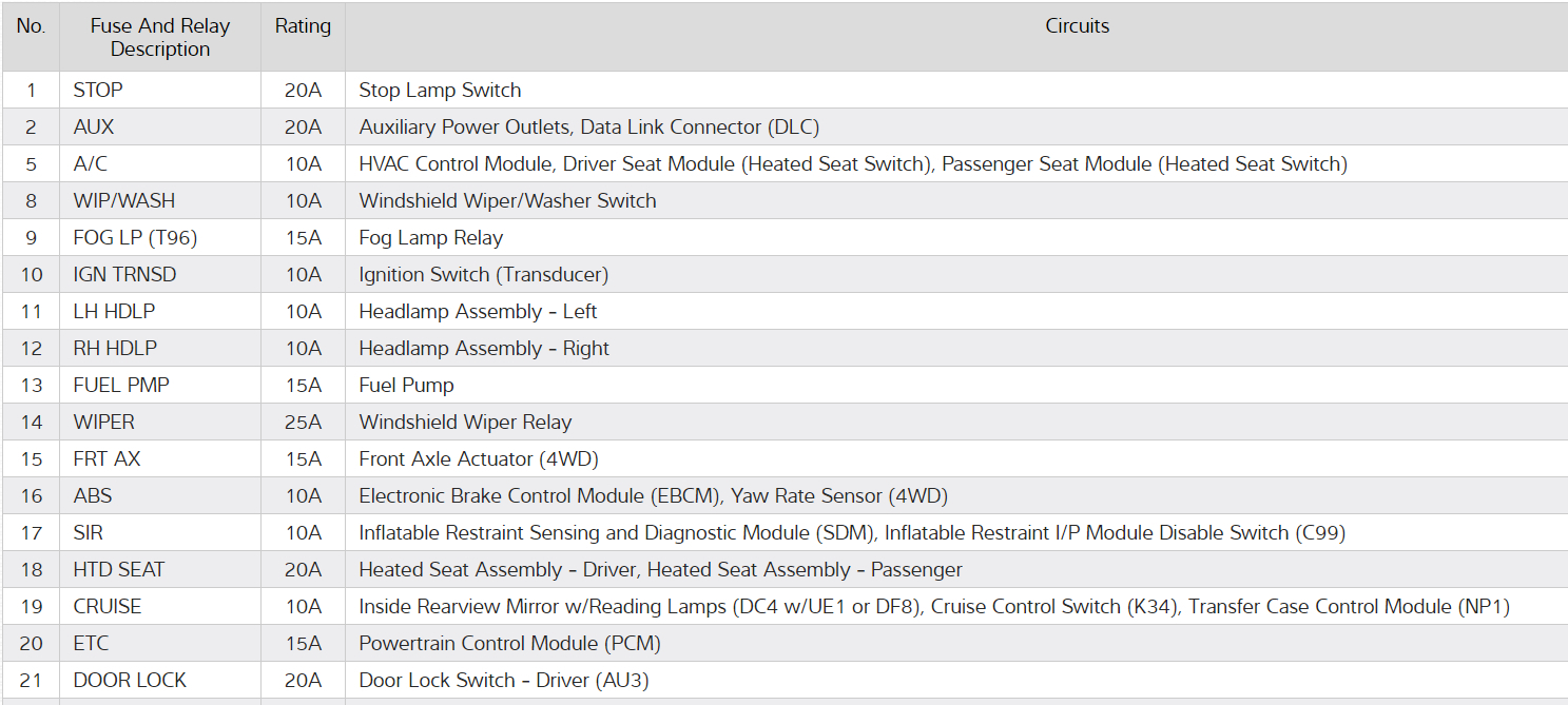

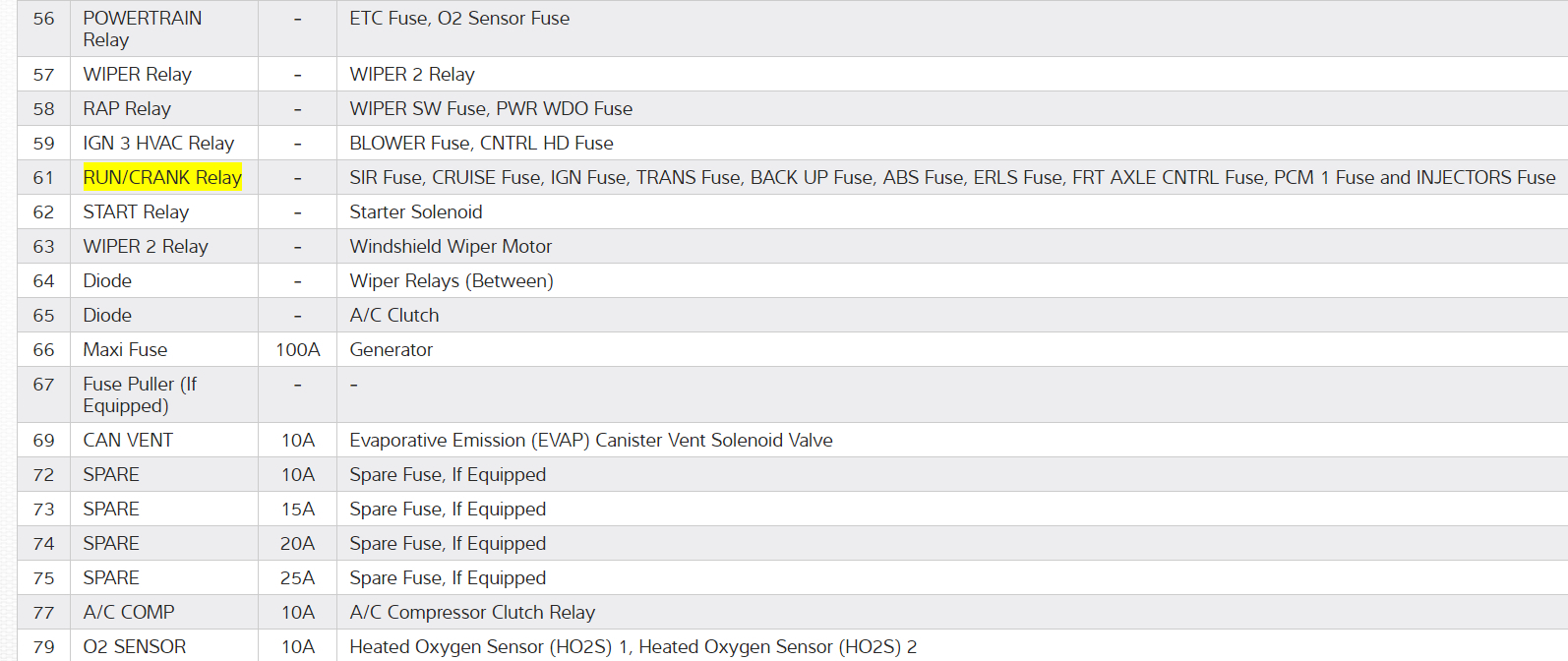

It sounds like you may have a blower motor that is out or fuse # 41. Here are two guides that will help test the fuse and the blower motor with the fuse location and how to change the blower motor in the diagrams below.
and
https://www.2carpros.com/articles/blower-fan-motor-works-on-high-speed-only
Check out the diagrams (Below). Please let us know what you find. We are interested to see what it is.

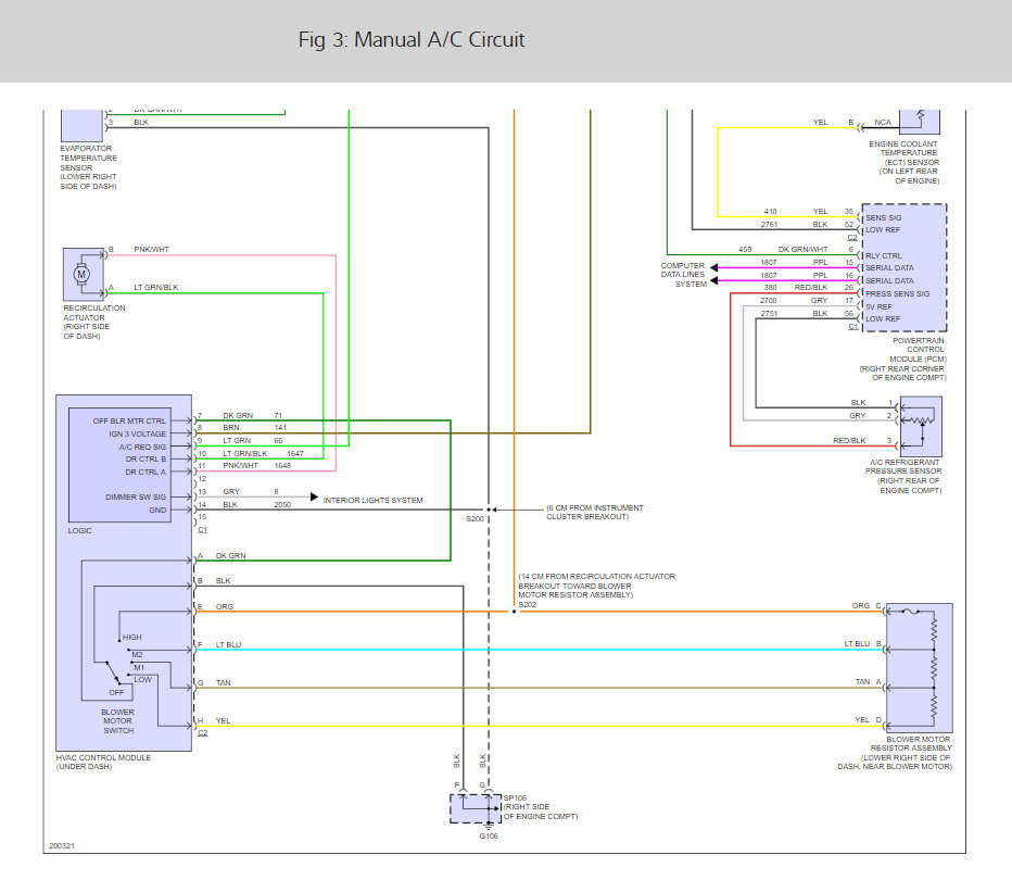

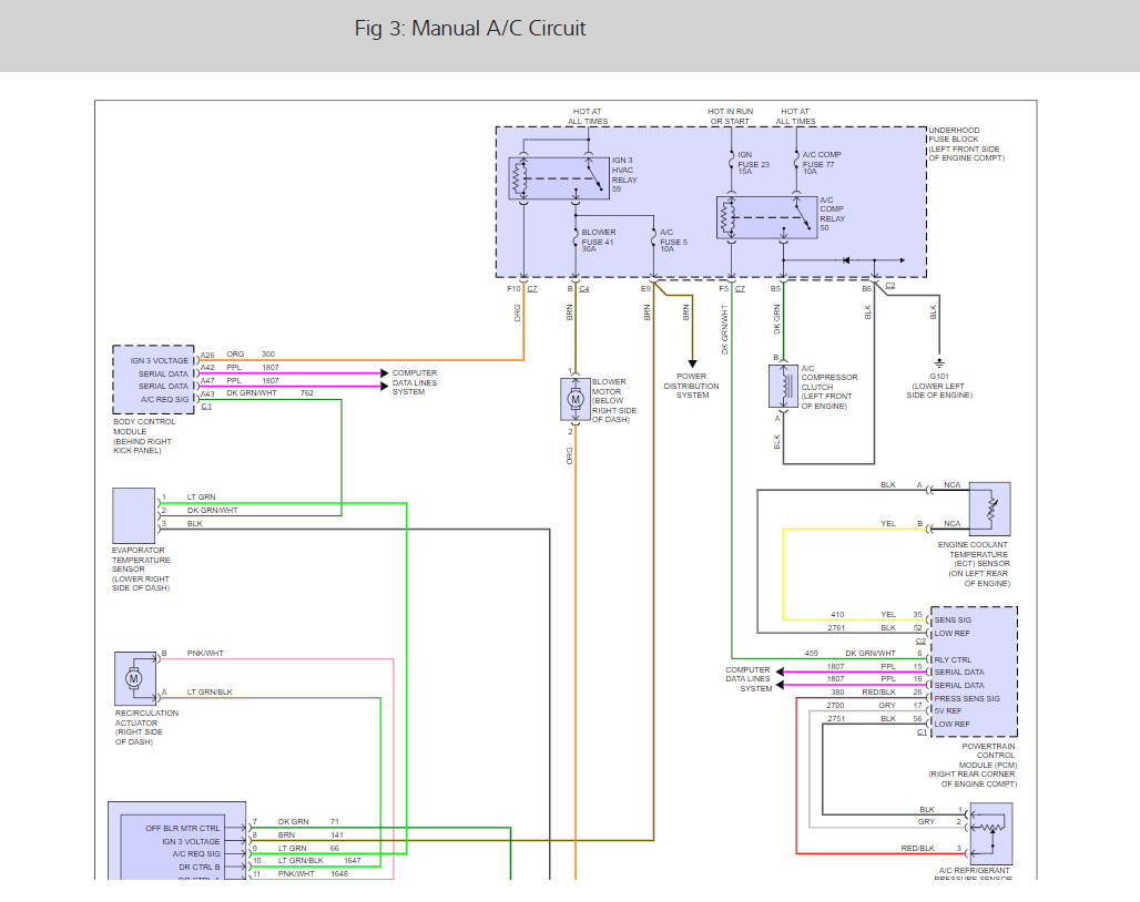

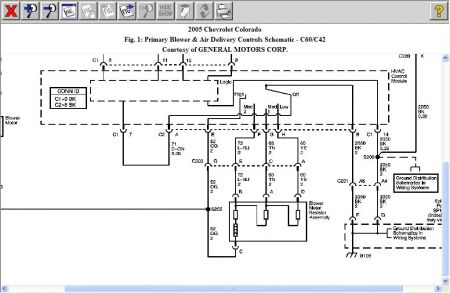

Problem seems to be due to an intermittent power failure. I have sent the schematic and diagniostic files to you. However it must be noted that since problem is intermittent, the test might not be accurate and some wiggling test is required, ie wiggle wire connectors to confirm the terminals are secure.

check to see if power is going to resistor when this happens, if it does replace the resistor. also check for hot wire harness it may be heating up and losing contact
Feb 4, 2019 at 8:33 AM (Merged)
WRENCHTECH
  • 20,761 POSTS
If you're testing for signal arriving at the resister, it's a ground signal that you're looking for, not power. The motor receives constant 12v.

Very good chance that the blower resistor is bad. Check for power at the resistor going into the resistor and then at the maotor to confirm. The high setting bypasses the resistor.

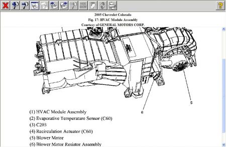

  • 75,992 POSTS
Test the blower motor resistor that's okay -problem is coming from the HVAC control module.
https://images.2carpros.com/forum/automotive_pictures/12900_blower_4.jpg
https://images.2carpros.com/forum/automotive_pictures/12900_blower_HVAC_control_module_1.jpg

Sorry fan motor is not serviceable.Sounds like a bushing running dry so replacement is necessary. It is located passenger side underdash in air plenum. It helps to remove glove box.

FACTORYJACK
  • 4,159 POSTS
Should be under the rh side of the dash, below the glove box, near the blower motor. It will more than likely have a 5-6 pin red connector body. Just FYI, if it has not been diagnosed fully, often times what happens is a poor connection at the resistor connector results in heat damage to the terminal, connector body, and resistor. It may need a wiring repair as well. Was very common on the H3 hummer, which is on the same platform as colorado/canyon.

  • 75,992 POSTS
Check the blower motor resistor item no.6 and the HVAC control assy on item no.1

it is a blower resistor.here is a bulletin with part numbers.Subject: Blower Motor Inoperative In Any One or More Blower Speed
Models: 2004-2006 Chevrolet Colorado
2004-2006 GMC Canyon Blower motor inoperative in one or more blower speeds. This concern is due to a loose connection at the blower motor resistor.
Recommendation/Instructions:
Inspect the connection at the blower motor resistor. Replace the blower motor resistor and any terminals in the female part of the connector that show evidence of arching or corrosion. The replacement connector and terminals are listed below.
Part Number 15306069, Female Connector With Leads. Replace the connector body with leads only if the connector body shows signs of damage. It may be necessary to generate a SPAC case to obtain this connector with leads.
Part Number 12176387, Replacement Female Terminal. This terminal is made of copper-beryllium and can be located in Delphi tray 3 of your Packard kit. Only replace the terminal(s) if the connector body has no evidence of damage.
Replace the blower motor resistor only if it shows signs of arching or corrosion at its terminals.
post back with the results.

Need blower motor resistor l;ocated in air plenum behind glove box area. just to left of motor.
