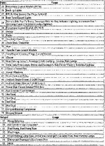

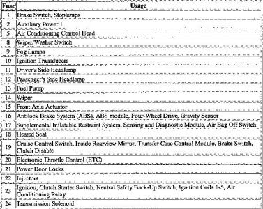

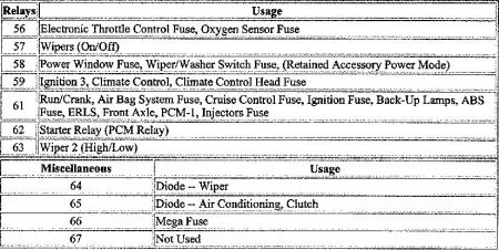

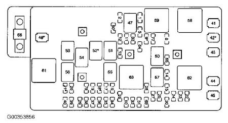

i need a fuse diagram . i bought the truck used and the manual and the cover for the fuse block are gone. my park , tail .tag and some of the int lights are not coming on. this has been going on for 3 days and once today they park lights came on but now are not.

https://images.2carpros.com/forum/automotive_pictures/261618_Noname_207.jpg
https://images.2carpros.com/forum/automotive_pictures/261618_Noname2_65.jpg
https://images.2carpros.com/forum/automotive_pictures/261618_Noname3_38.jpg
https://images.2carpros.com/forum/automotive_pictures/261618_Noname4_23.jpg
If you can't read diagrams, give me e-mail address and I will email to you. Thanks for using 2CarPros.com!
