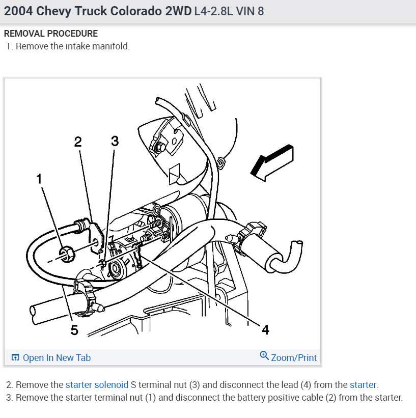

How do i change my starter on my truck?

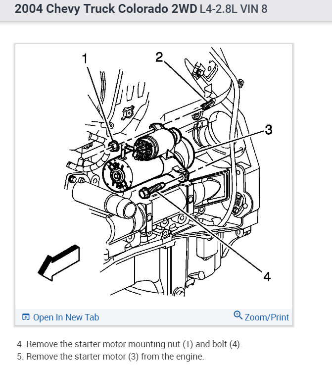

Here is a guide that will walk you through the steps of replacing the start with diagrams and instructions below to show you how on your truck.

im trying to replace the starter on my truck . it has a 3.5 in line 5 cyl an i cant figure how to reach the other bolt on the starter . i cant see it but theres two 15mm bolts an it s in a bad spot and dont want to take anything off i wouldnt have to...

THey are a pain. You will need to work from top and bottom to remove iit. Also, see if you can gain access through the inner finder.
