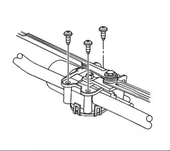

windshield wipers stopped working out of the blue yesterday. Turn my switch and nothing. I'm thinking it's the moter but where can I locate it to check on my car?

WIPER MOTOR REPLACEMENT REMOVAL PROCEDURE Remove the air inlet grille panel. Remove the wiper drive system module. Remove the wiper crank arm nut. Remove the wiper crank arm from the wiper motor.
https://images.2carpros.com/forum/automotive_pictures/12900_wm_2.jpg
Remove the wiper motor screws. Remove the wiper motor from the wiper drive system module. INSTALLATION PROCEDURE
Position the wiper motor to the wiper drive system module. NOTE: Install the wiper motor screws. Tighten the screws to 8 N.m (71 lb in). Install the wiper motor crank arm and crank arm nut. Tighten the screws to 25 N.m (18 lb ft). Install the wiper drive system module. Install the air inlet grille panel. https://www.2carpros.com/kpages/auto_repair_manuals_alldata.htm
