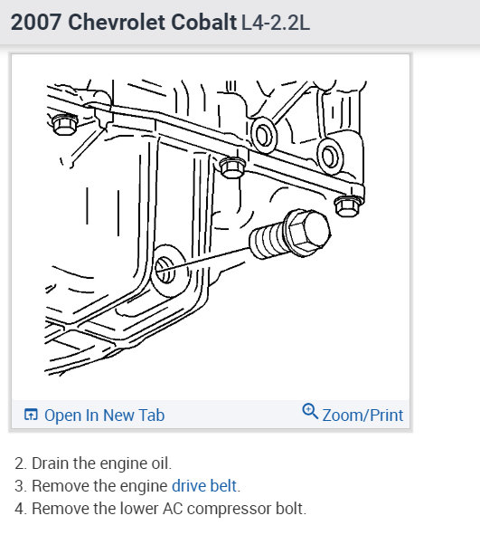

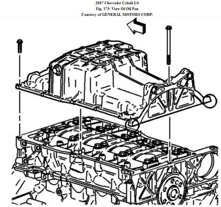

The kid took a dip in the ditch a came away with about a 1 inch gash in the oil pan. He can weld the gash, but we are having trouble getting the oil pan off. Just how many bolts and how far (up into the engine) do we have to go to get this thing off?

You will have to remove any motor/trans mounts in the way and raise engine a few inches to get the pan off. Here are the instructions in the diagrams below to show you how to replace the oil pan. Check out the diagrams (Below). Please let us know if you need anything else to get the problem fixed.

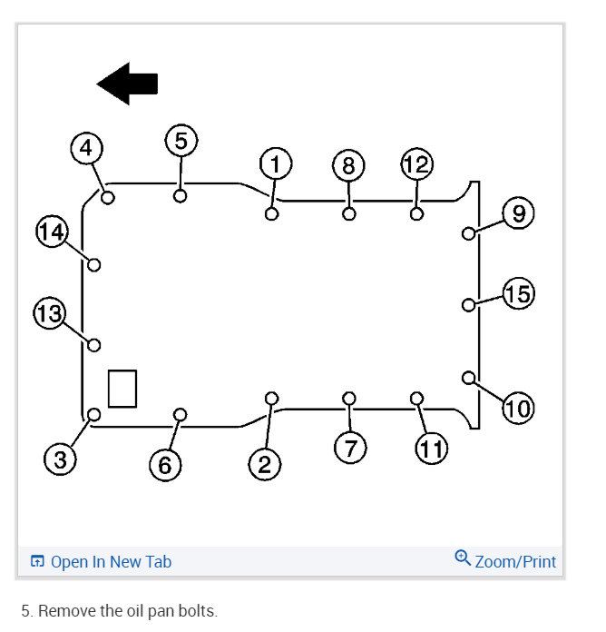

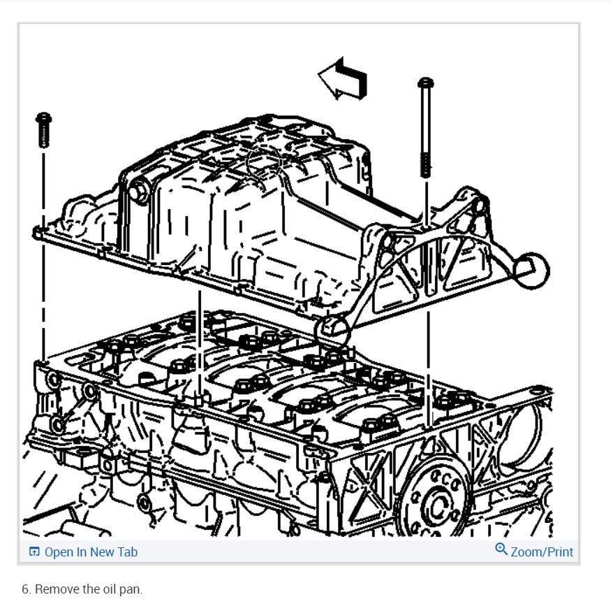

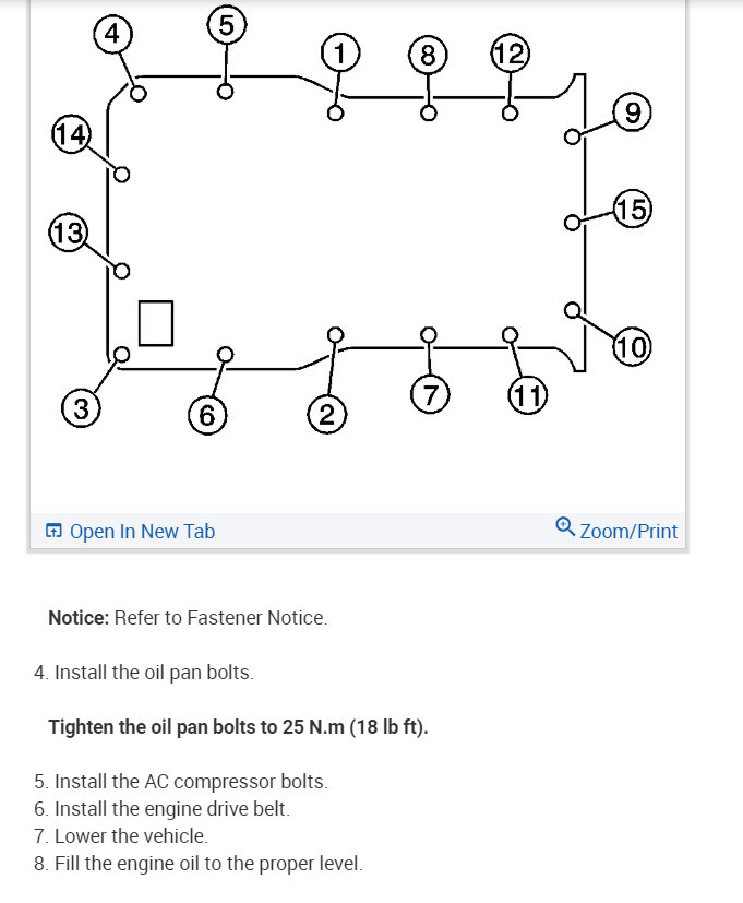

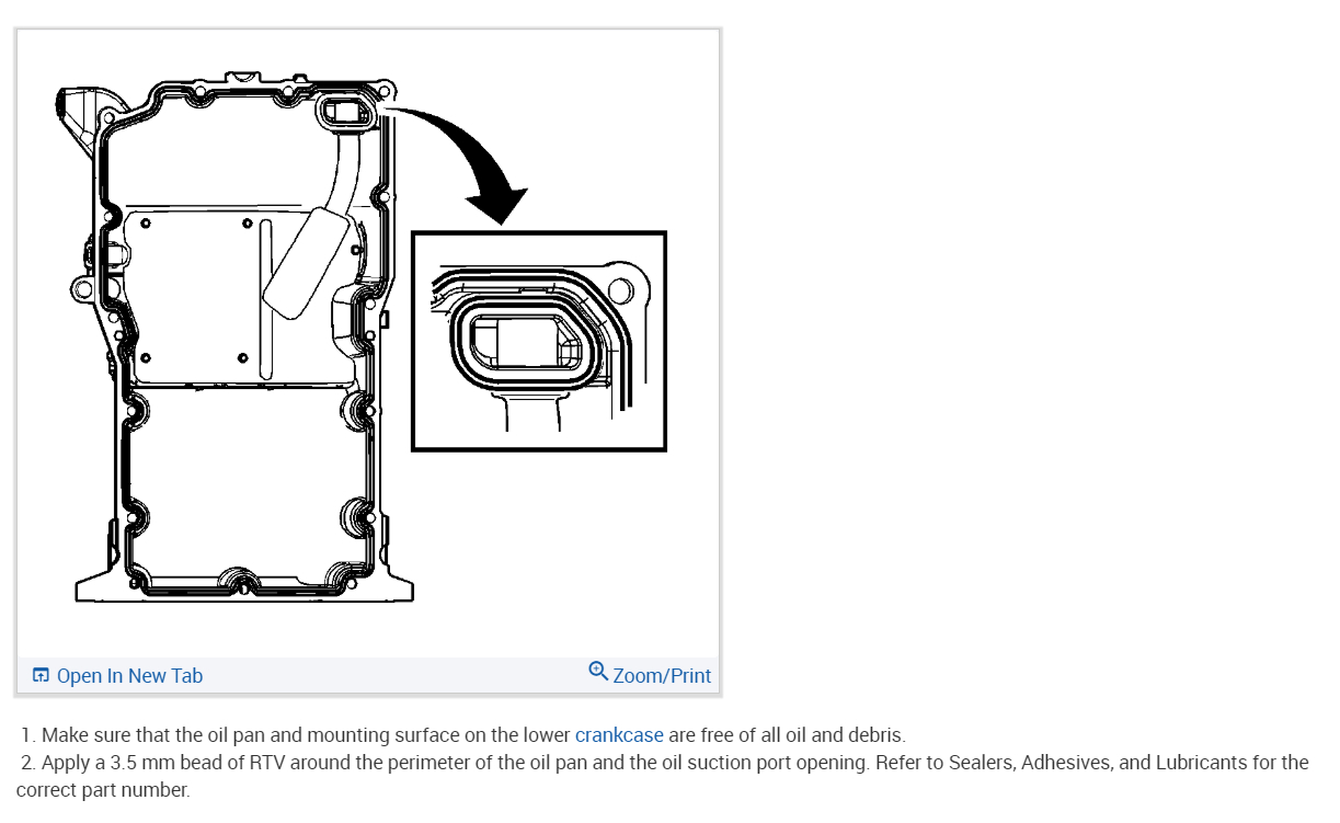

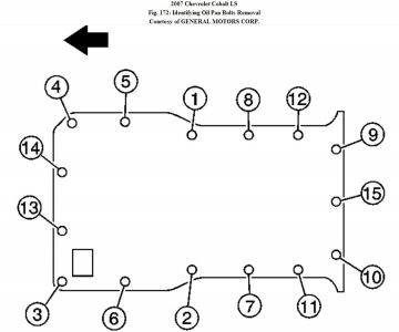

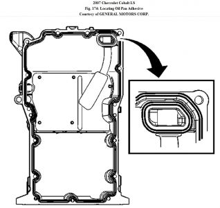

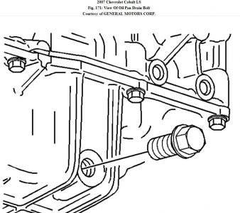

Yes, the engine does NOT need to be removed, here's how: Removal Procedure 1. Raise and support the vehicle. Refer to Lifting and Jacking the Vehicle . Fig. 171: View Of Oil Pan Drain Bolt Courtesy of GENERAL MOTORS CORP. 2. Drain the engine oil. 3. Remove the engine drive belt. Refer to Drive Belt Replacement . 4. Remove the lower AC compressor bolt. Fig. 172: Identifying Oil Pan Bolts Removal & Tightening Sequence Courtesy of GENERAL MOTORS CORP. 5. Remove the oil pan bolts. Fig. 173: View Of Oil Pan Courtesy of GENERAL MOTORS CORP. 6. Remove the oil pan. Installation Procedure Fig. 174: Locating Oil Pan Adhesive Courtesy of GENERAL MOTORS CORP. 1. Make sure that the oil pan and mounting surface on the lower crankcase are free of all oil and debris. 2. Apply a 3.5 mm bead of RTV around the perimeter of the oil pan and the oil suction port opening. Refer to Sealers, Adhesives, and Lubricants for the correct part number. Fig. 175: View Of Oil Pan Courtesy of GENERAL MOTORS CORP. 3. Install the oil pan. Fig. 176: Identifying Oil Pan Bolts Removal & Tightening Sequence Courtesy of GENERAL MOTORS CORP. 4. Install the oil pan bolts. Tighten: Tighten the oil pan bolts to 25 N.m (18 lb ft). 5. Install the AC compressor bolts. Refer to Compressor Replacement (RPO LSJ) or Compressor Replacement (RPOs L61, LE5) . NOTE: Refer to Fastener Notice . 6. Install the engine drive belt. Refer to Drive Belt Replacement . 7. Lower the vehicle. 8. Fill the engine oil to the proper level.
