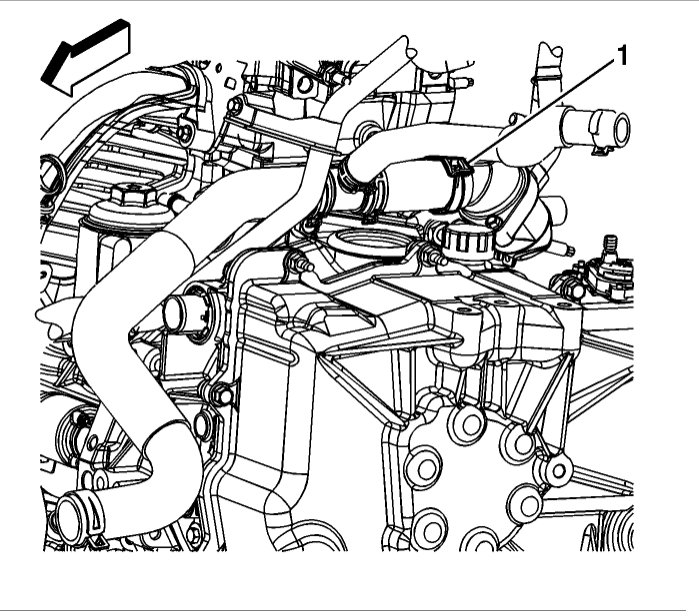

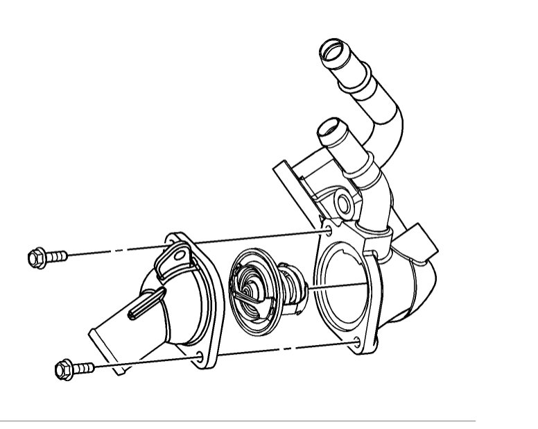

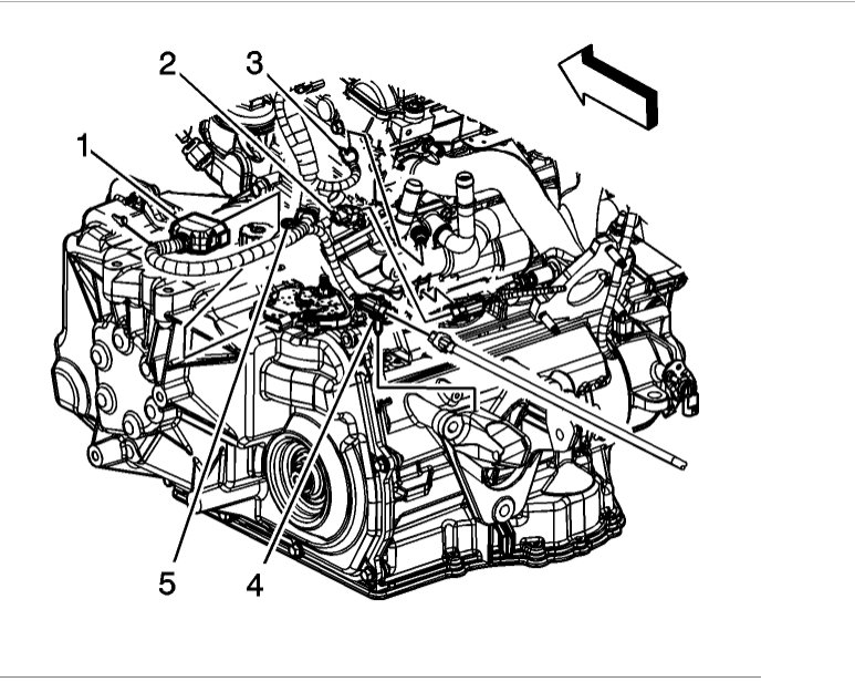

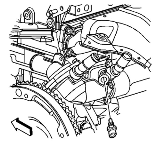

I have a 2007 Chevy cobalt LS with a 2.2 liter ecotec engine, I am having problems with the coolant temperature sensor. I have replaced the sensor twice already and it continues to act up. It will not read when the outside temperature is below 60 degrees Fahrenheit. If i start it from a cold start then drive for a few miles it will read up to 170F° then it will hover around 165 to 170 then it will get stuck on a random temperature in between Then it will read followed by the radiator fan coming on and running constantly. After all of this happens the engine light will come on after a few more miles. Can someone please help me?

This sounds like a stuck thermostat so I will give you instructions on both. Here is a guide for the sensor that will give you and idea on what you are in for when doing the job.

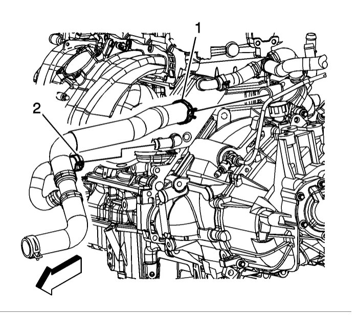

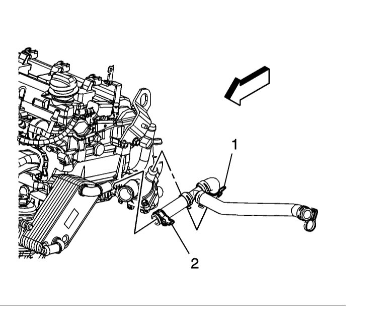

Here are some diagrams to help you get the job done on your car (below)

not exactly sure where the thermostat is on my car until I noticed the diagram you gave. I was once told to follow the upper radiator hose and it should be at the end of that.
Sep 30, 2010 at 2:28 PM
BLUELIGHTNIN6
  • 16,542 POSTS
the thermostat is located behind the engine under the exaust manifold on the drivers side. just look for the water pump tube and you will find it.
Sep 30, 2010 at 2:31 PM
SAMMS21
  • 21 POSTS
is eat easy to replace? just unbolt and put the new one in or is it more complicated.
Sep 30, 2010 at 2:34 PM
BLUELIGHTNIN6
  • 16,542 POSTS
thats the jist of it , getting to it is the ...not really the hard part but the time consuming part. here are some instructions to help .. Removing the intake manifold cover: Remove the engine oil fill cap. Grasp the intake manifold cover by the lower right inboard corner and pull up to disengage the cover from the stud. Grasp the intake manifold cover by the upper left corner and pull up to disengage the cover from the stud. Remove the intake manifold cover. Drain the cooling system. Reposition the radiator outlet hose clamp at the thermostat cover. Remove the radiator outlet hose from the thermostat cover. Reposition the radiator surge tank outlet hose clamp at the thermostat cover. Remove the radiator surge tank outlet hose from the thermostat cover. Reposition the radiator outlet hose clamp (1) at the thermostat cover. Remove the radiator outlet hose from the thermostat cover. Remove the thermostat cover bolts and cover. Remove the thermostat. Remove and discard the thermostat cover O-ring seal.

Thanks you the thermostat seemed to do the trick it is all fixed, thanks a million guys, this site rocks.

The sending unit should be either on the cylinder head or near the thermostat.
