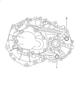

I'm replacing the clutch, and cannot find the drain plug. I'm going step by step in the book, just got suck at this one. I have the driver side wheel off like it said; I found the view/fill plug. Thanks

Drain plug no. 1
https://images.2carpros.com/forum/automotive_pictures/198357_Graphic_321.jpg
