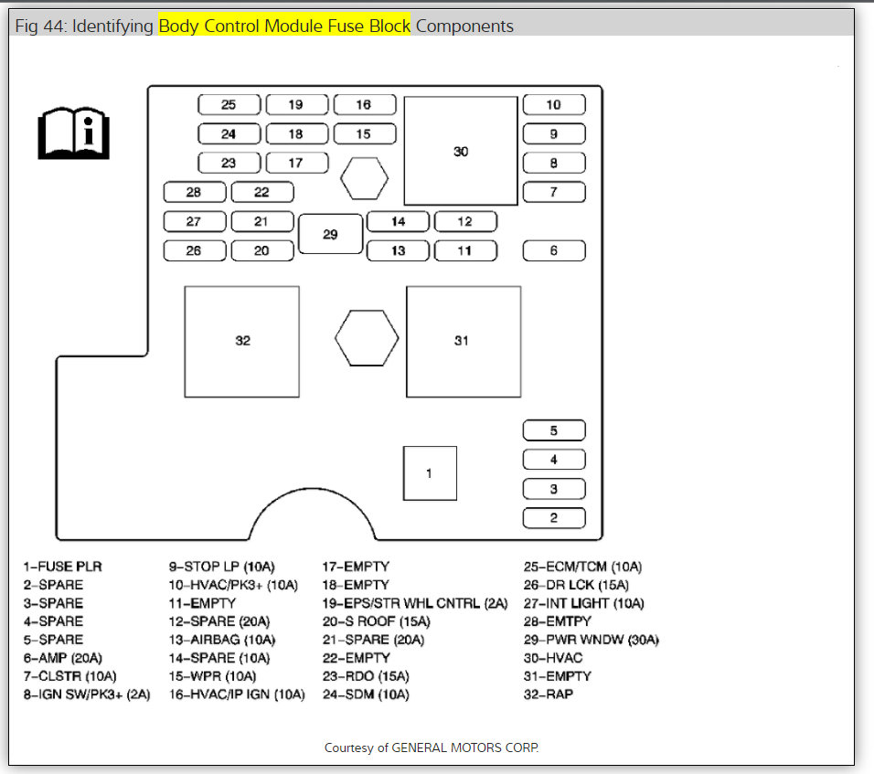

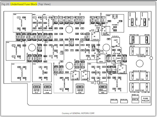

My stereo just stopped working, it has no clock display or anything. HELP!
Mar 5, 2010 at 12:54 PM
  • 55,423 POSTS

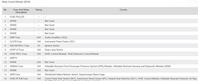

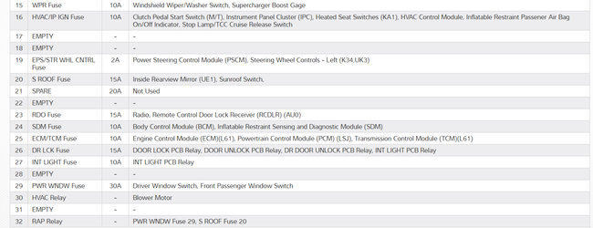

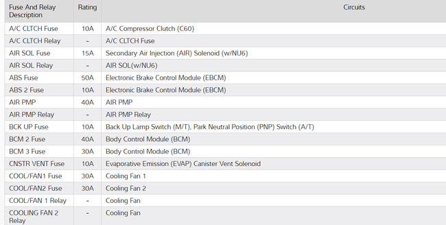

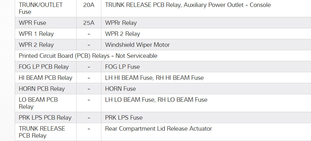

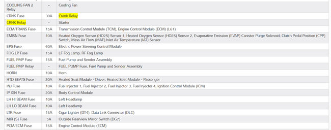

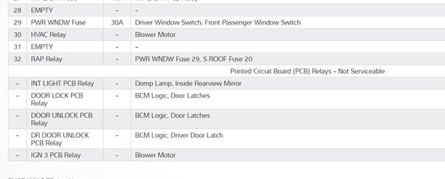

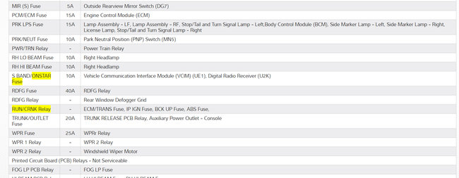

I'd start by checking the fuse #23 that run the radio first. Here is a guide to show you how.
Mar 12, 2010 at 8:03 AM
PRSCLLWEBB
Yep the fuse was blown it started after I had the car jump started. Thanks I love this site
