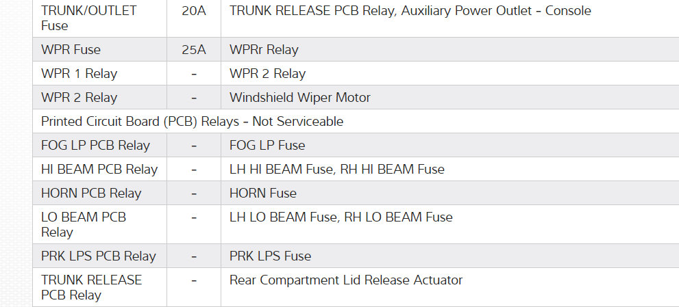

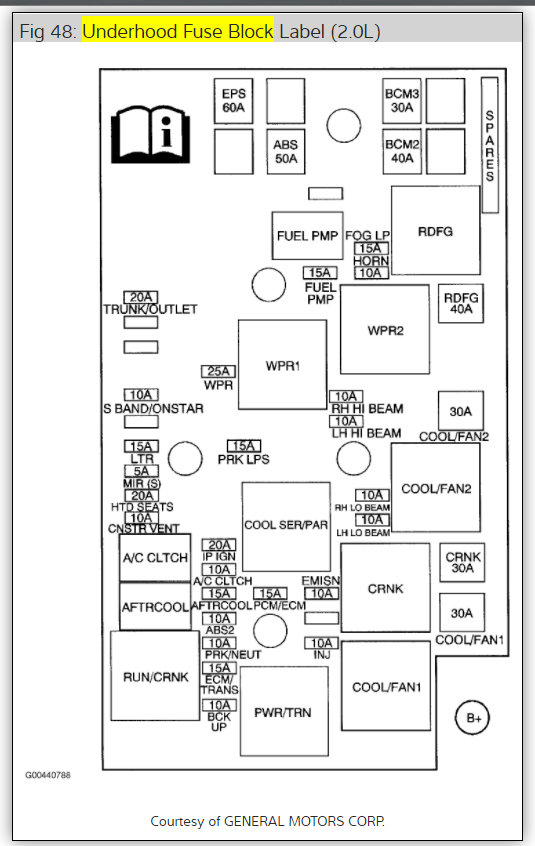

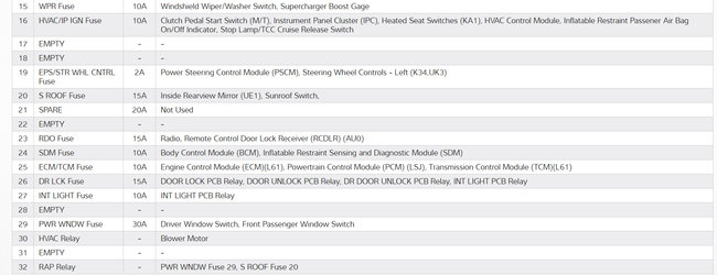

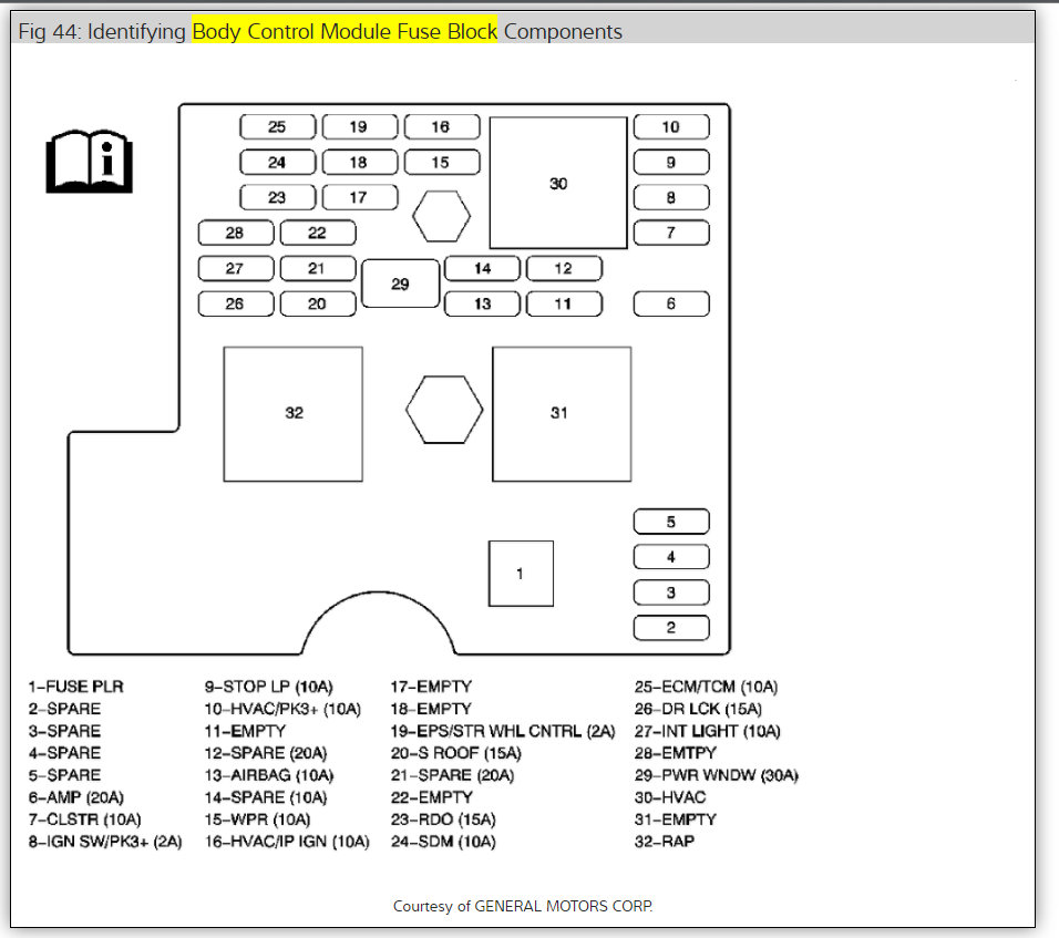

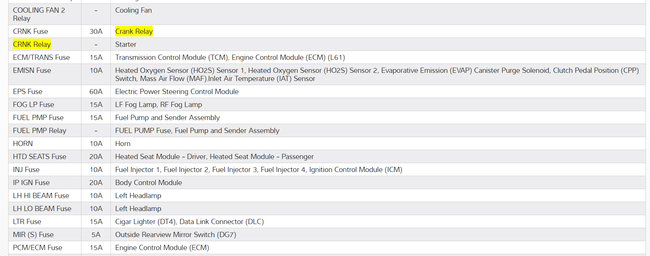

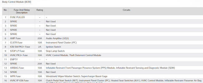

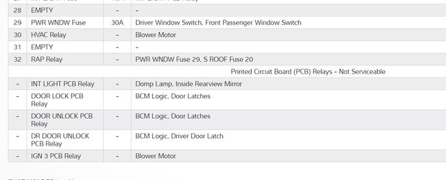

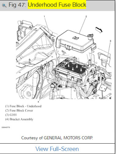

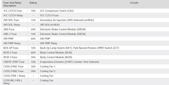

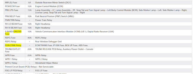

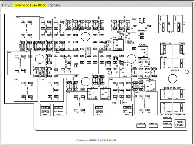

Check your fuses. Here is a guide to help and the fuse location in the diagrams below.
Check out the diagrams (Below). Please let us know what you find.
May 19, 2009 at 1:49 AM
FRANMOSSO
  • 5 POSTS
I checked every fuse under the hood and inside the car and all were good. A diagram would be awesome. Thanks
