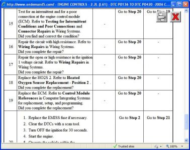

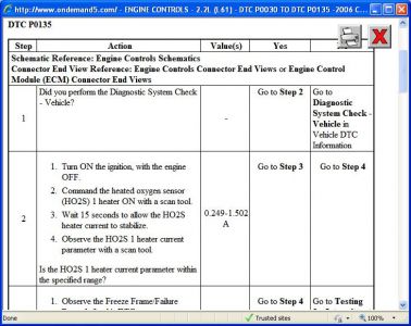

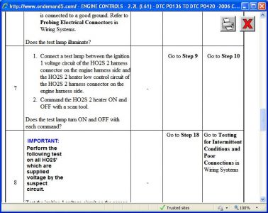

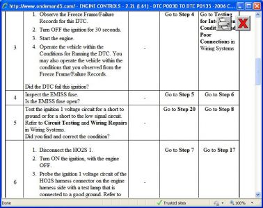

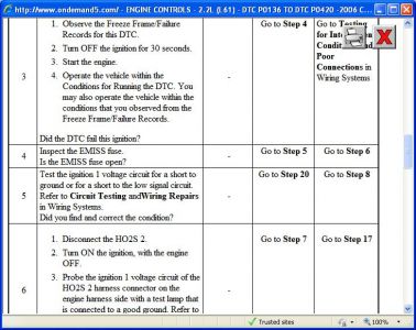

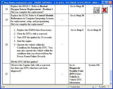

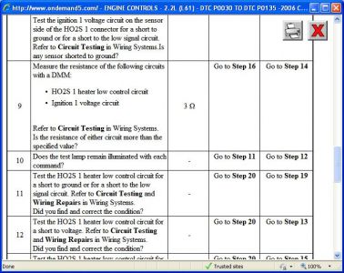

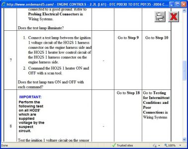

https://images.2carpros.com/forum/automotive_pictures/416332_2006_cobolt_p0135_part1_1.jpg

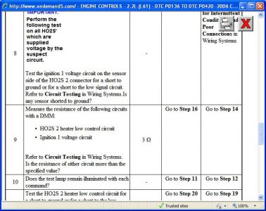

https://images.2carpros.com/forum/automotive_pictures/416332_2006_cobolt_p0135_part2_1.jpg

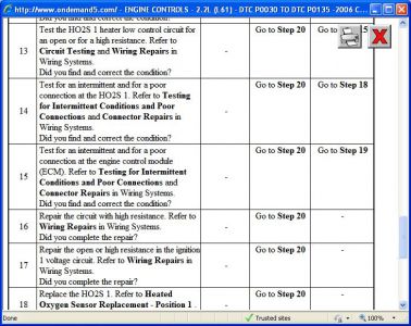

https://images.2carpros.com/forum/automotive_pictures/416332_2006_cobolt_p0135_part3_1.jpg
https://images.2carpros.com/forum/automotive_pictures/416332_2006_cobolt_p0135_part4_1.jpg
https://images.2carpros.com/forum/automotive_pictures/416332_2006_cobolt_p0135_part5_1.jpg
https://images.2carpros.com/forum/automotive_pictures/416332_2006_cobolt_p0135_part6_1.jpg

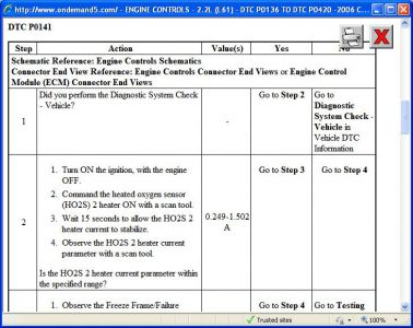

https://images.2carpros.com/forum/automotive_pictures/416332_2006_cobolt_p0141_part1_1.jpg

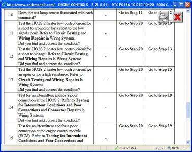

https://images.2carpros.com/forum/automotive_pictures/416332_2006_cobolt_p0141_part2_1.jpg

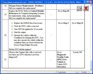

https://images.2carpros.com/forum/automotive_pictures/416332_2006_cobolt_p0141_part3_1.jpg
https://images.2carpros.com/forum/automotive_pictures/416332_2006_cobolt_p0141_part4_1.jpg
https://images.2carpros.com/forum/automotive_pictures/416332_2006_cobolt_p0141_part5_1.jpg
https://images.2carpros.com/forum/automotive_pictures/416332_2006_cobolt_p0141_part6_1.jpg
https://images.2carpros.com/forum/automotive_pictures/416332_2006_cobolt_p0141_part7JPG_1.jpg
follow the trouble trees try skipping the first 2 instructions on both trouble trees since they ask you too do a special that only very few scanners can do.you will need a scan tool that can read engine data stream like o2 readings etc.let me know what you find.
