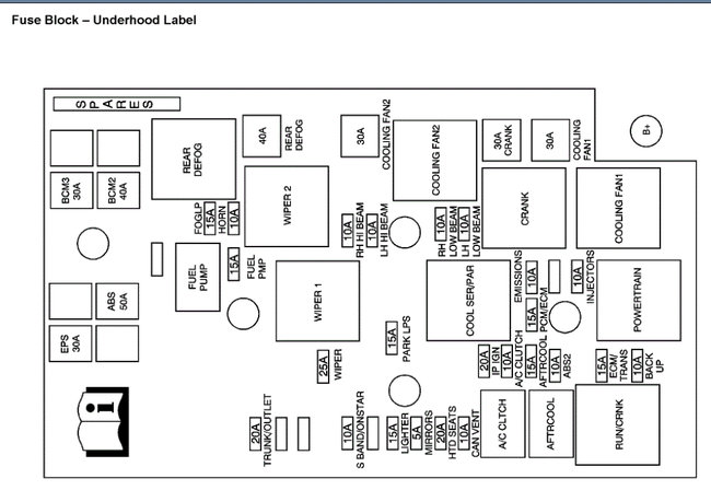

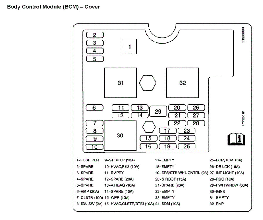

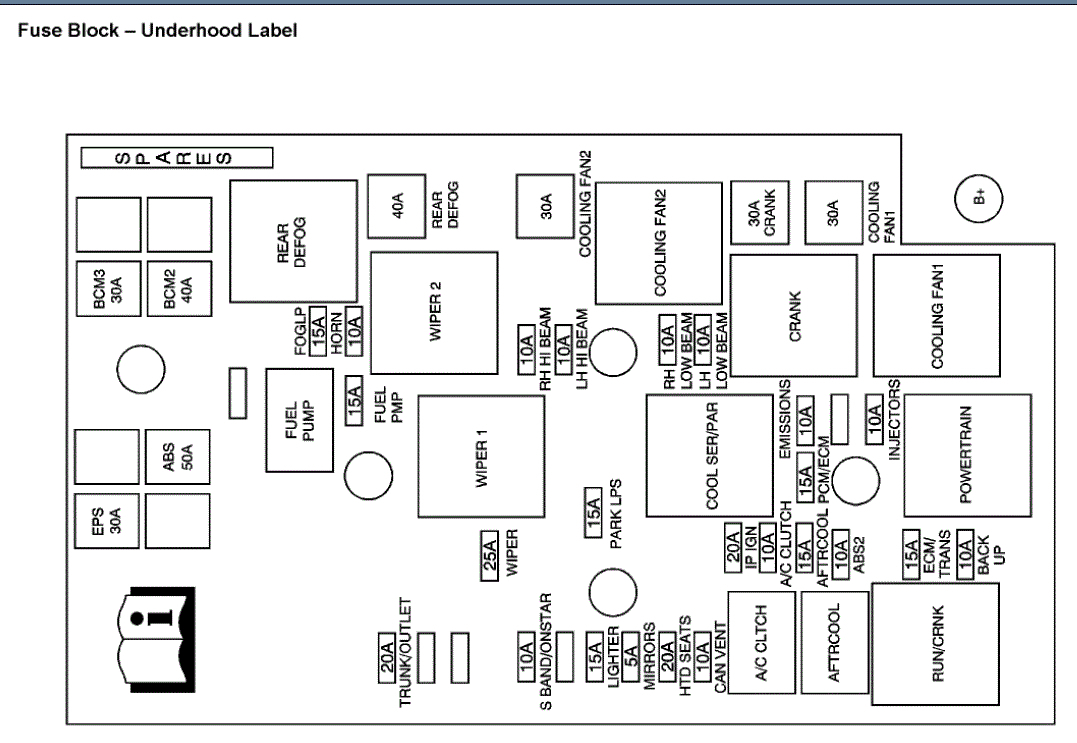

The door locks are not working where are the fuses and how can I check them?
Jan 15, 2009 at 9:07 AM
  • 110,244 POSTS

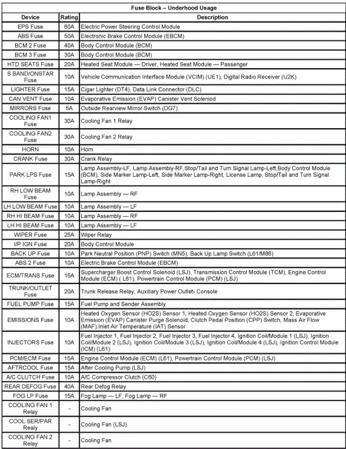

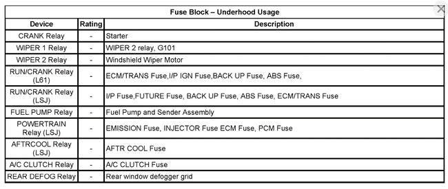

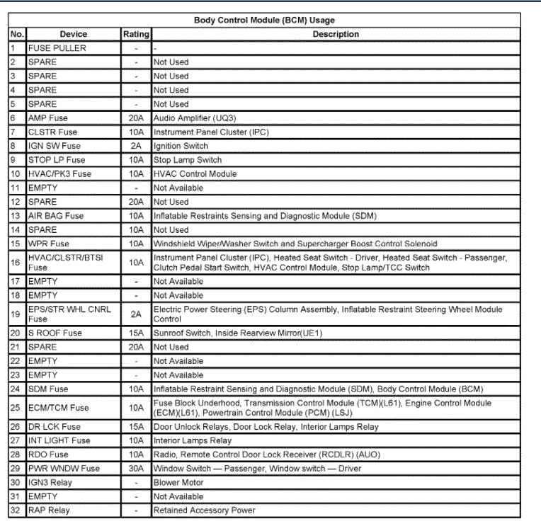

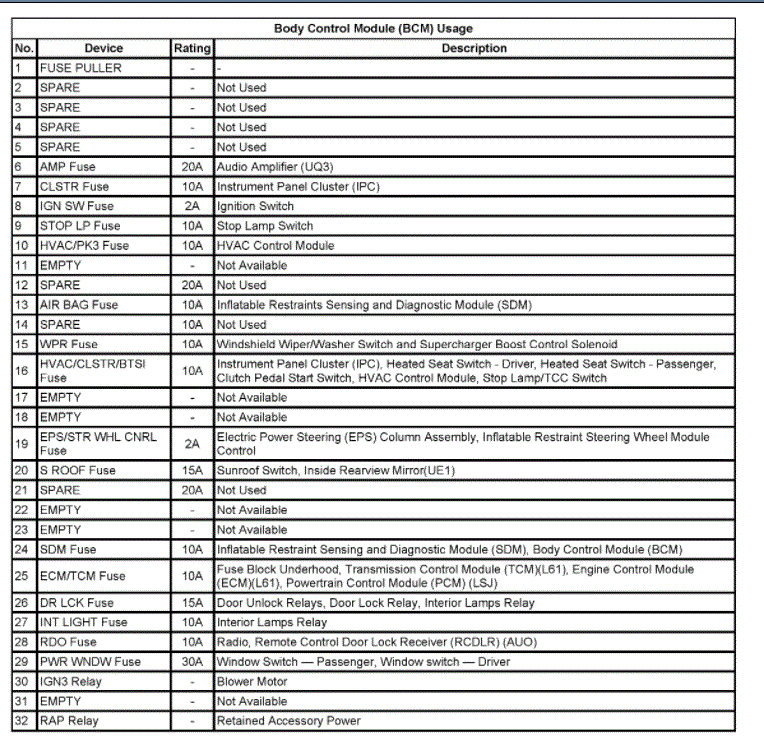

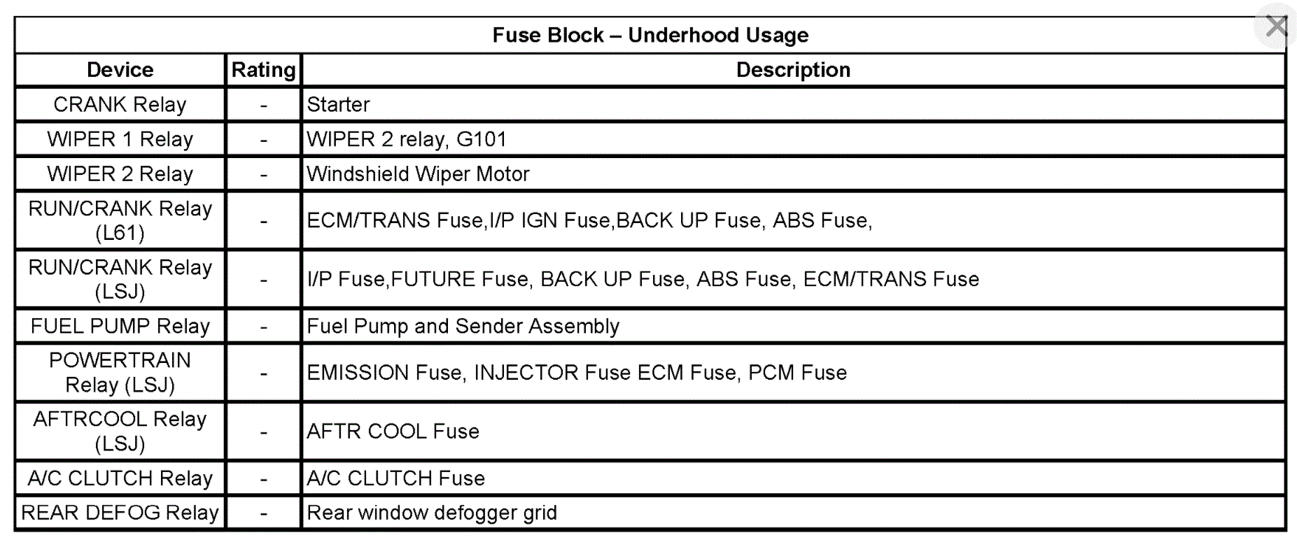

If you look at the attachments below, they provide the fuse box orientations and what each fuse is for.
In addition to just checking a fuse, make sure there is power to it. A fuse may be good and not be receiving power.
Here is a link that you may find helpful when testing:
I hope this helps. Let me know if you have additional questions.
