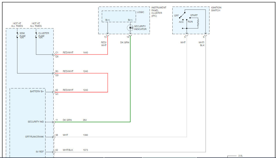

sometimes when you go to start my car the anti-theft light is on and the car wont start and other times my car starts right up what would be the problem?
Jan 8, 2010 at 4:29 AM
DANNY L
  • 5,648 POSTS
Hello again.
I would first suggest performing an anti-theft, security system reset. Here is the tutorial showing how to perform this:
https://www.2carpros.com/articles/how-to-reset-a-security-system
Just curious to know if the check engine light is on? Here is a tutorial showing how to check for codes if the check engine light is on:
Here is another tutorial for you to view showing a no-start condition:

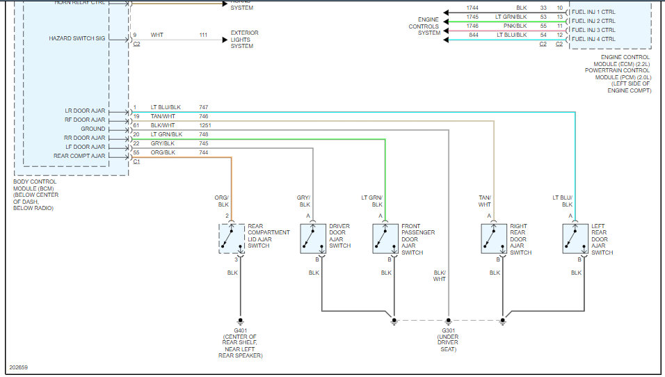

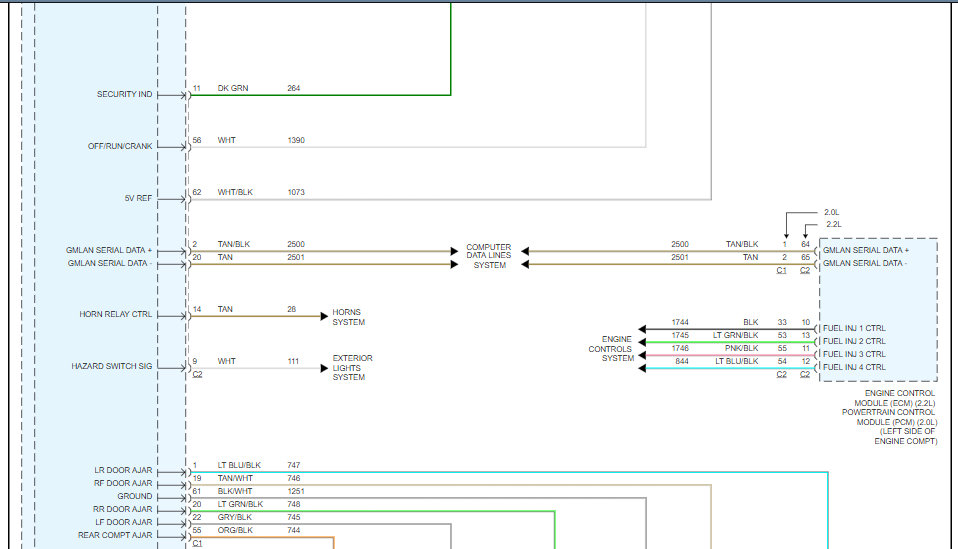

In case there is an issue with the wiring on the anti-theft system I've attached a the wiring diagram below for your Cobalt. I've cut the picture into 3 pieces so you can view larger. Here is a tutorial showing how to test wiring.
