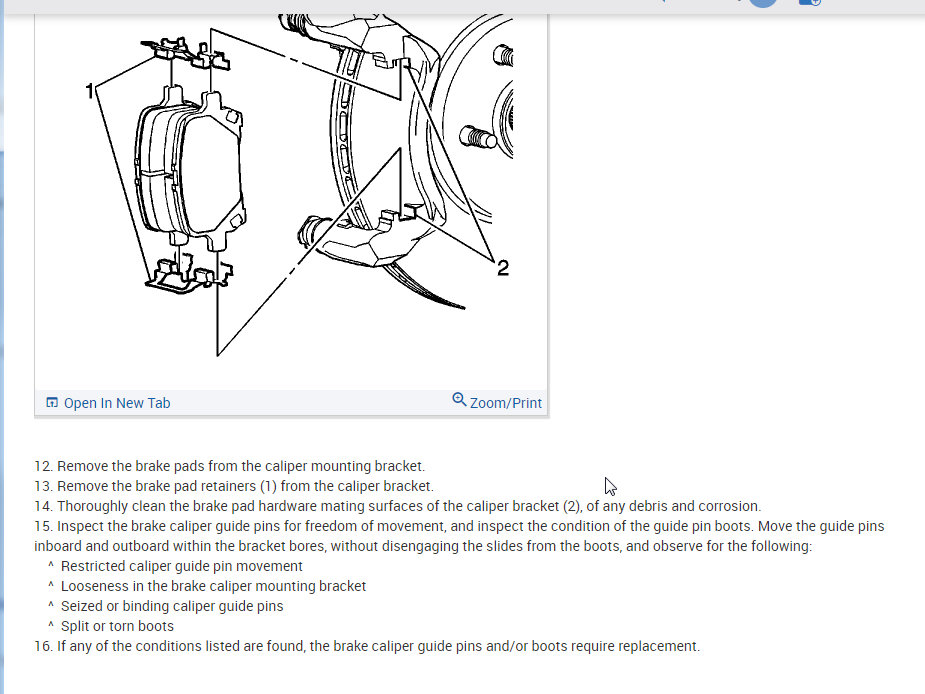

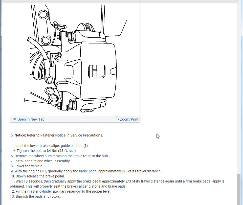

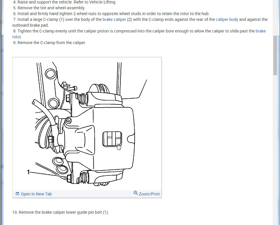

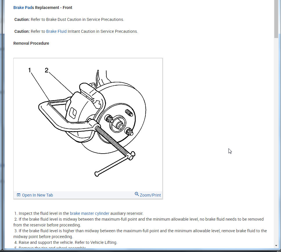

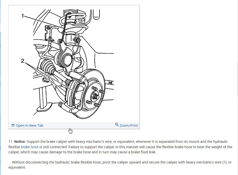

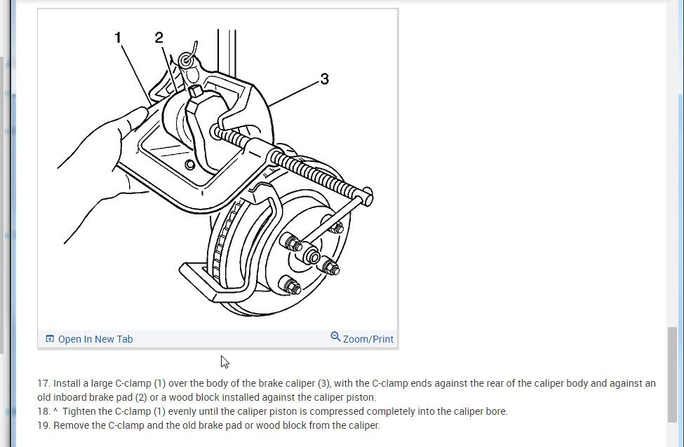

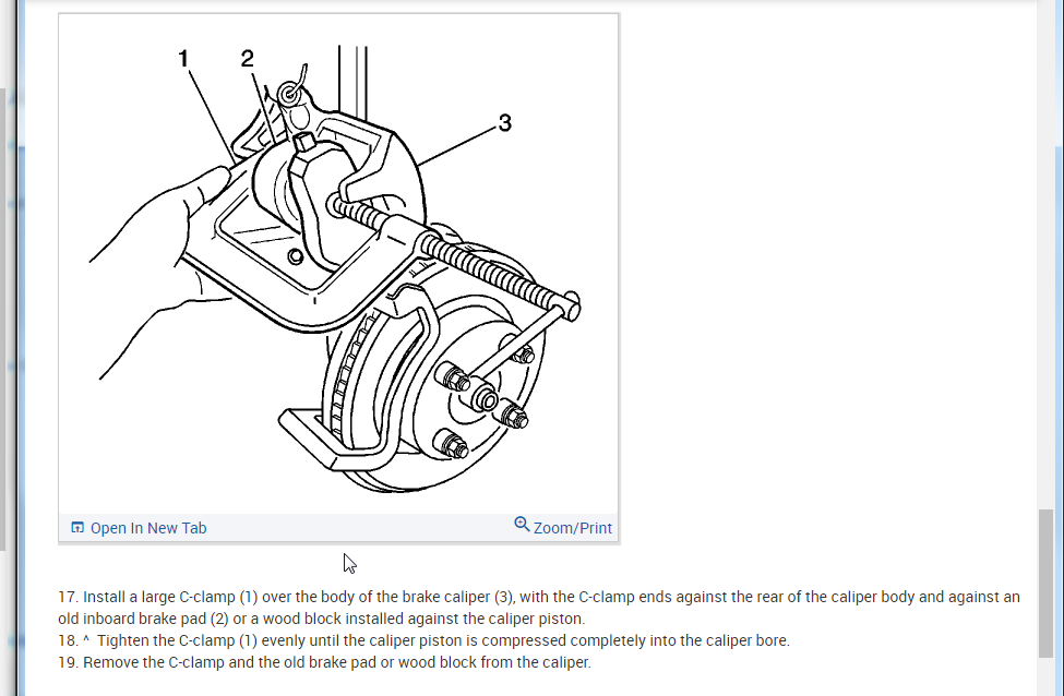

the front pads are low can you help me save money please?
Oct 11, 2010 at 12:19 AM

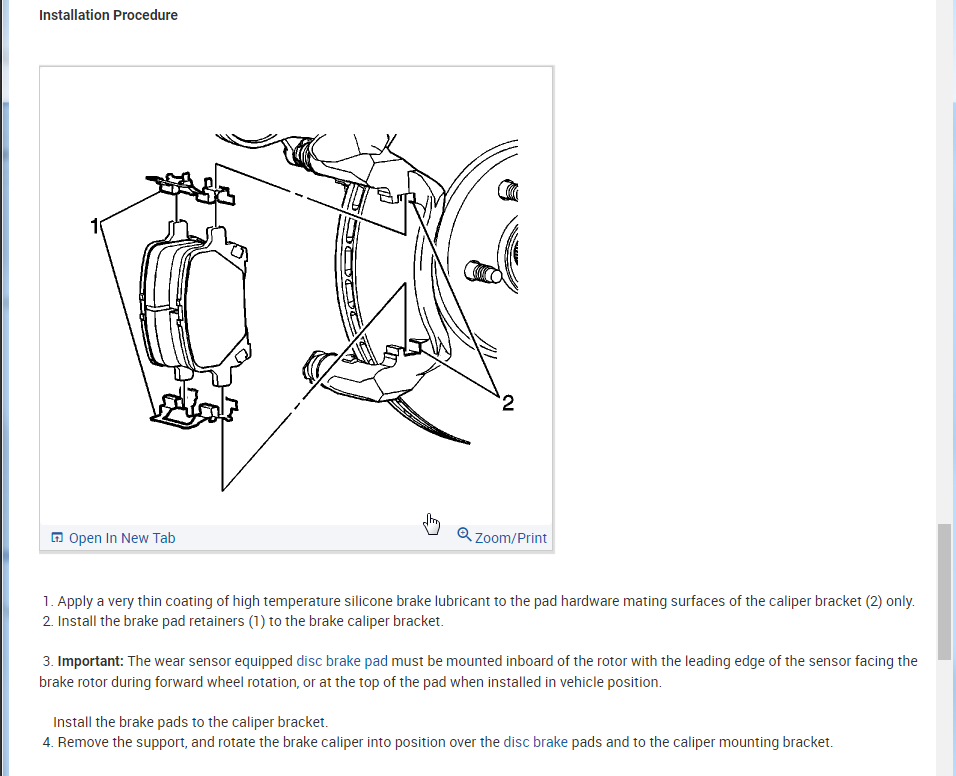

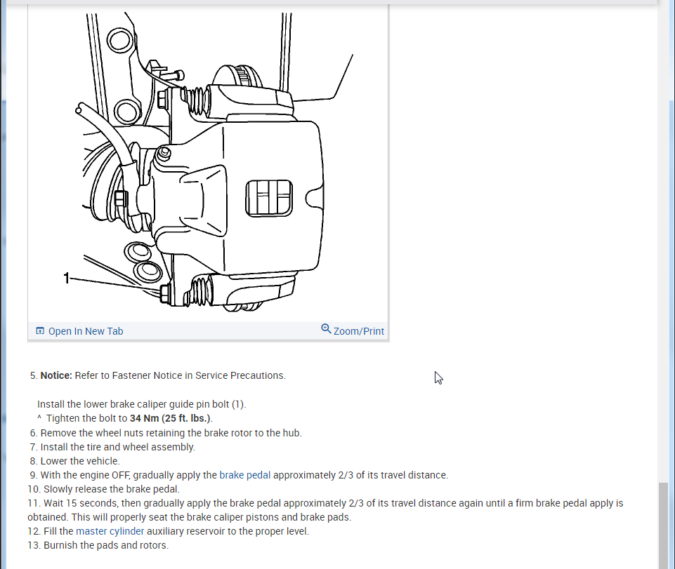

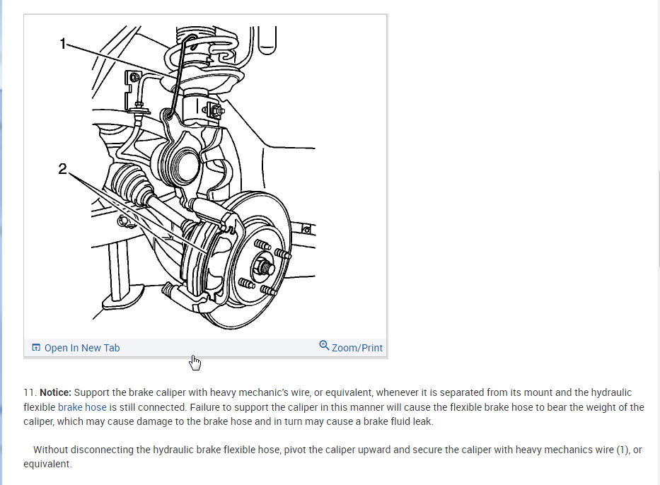

Here is a guide that will help with step by step instructions on how to do this:
Plus here is a video of a similar vehicle that will help as well:
https://www.youtube.com/watch?v=W1Bx2Gm_BuM
Below is the process from the manual that will give the detail as well.
Please let us know if you have other questions. Thanks
