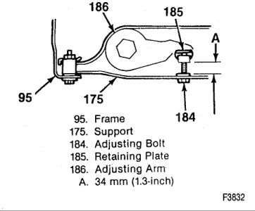

How do I release the tension on the torsion bar to remove the lower control arm

Follow the torsion bar back to the other end and there will be an adjustment bolt that has to be backed off all the way.
