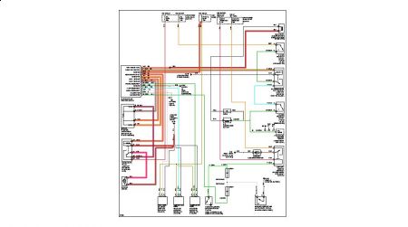

Ok I have changed the switch, and the relay and the blower motor. I am getting juice to the motor when the switch is turned to high but the motor doesn't turn.
I get no power on any of the other settings.
Does that mean it is the resistor??
I think that is all thats left to change!!
cheers
Flash
Aug 4, 2009 at 9:44 AM
  • 75,992 POSTS
Do this disconnect the purple and black wire connector on the blower motor-power the motor from the battery positive connect it to the purple wire the black wire is the ground circuit If it powers up its coming from the AC/Heater control module. Also check the heaterand AC fuse 25amp in the fuse block this one powers the module

  • 12 POSTS
razmataz
is there anyway you can post or email Me the wiring diagram. The resolution isn't high enough for Me to read it.
I have replaced the switch.. Is the control module something else??
My email is flash@ce2engineers.com or beautysmistress@gmail.com
thanks again for all the help
Aug 4, 2009 at 10:53 AM
  • 75,992 POSTS
Just sent it a few secs ago-Good Luck
