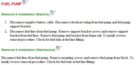

how do you take out and replace a fuel pump in a 1995 chevy cheyenne deisel truck

https://images.2carpros.com/forum/automotive_pictures/261618_Noname_2380.jpg
