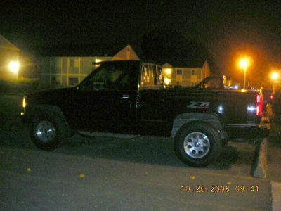

okay could you help me out with where my starter is located on my truck thank you mindee[img:90c083ea22]http://www.2carpros.com/forum/automotive_pictures/264133_TRUCK_2_2.jpg[/img:90c083ea22]

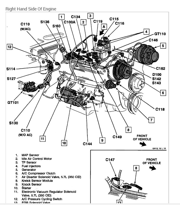

Yes the starter is located on the right side of the engine tworred the rear down low. Here is a guide to help walk you through the repair with diagrams in the images below for your truck.

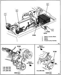

Should be located at the bottom rear of the engine. Just follow your positive cable from your battery and that will lead you to it.

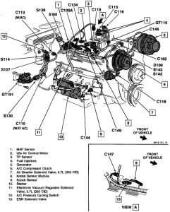

Hello Bluelightnin6 gave some excellent advice. I wasnt sure if you wanted a pic of where it was or not. Here is a pic of your starter location. Thanks for using the site.
https://images.2carpros.com/forum/automotive_pictures/248015_Starter_1_1.jpg
https://images.2carpros.com/forum/automotive_pictures/248015_Starter_2_1.jpg
