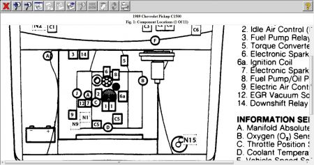

Fuel pump relay at no.3 on right side of firewall behind battery junction block cover
https://images.2carpros.com/forum/automotive_pictures/12900_fp_relay1_1.jpg
