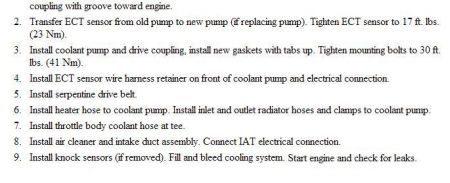

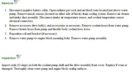

How do you Replace A waterpump in a 1995 Corvette
