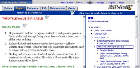

1986 Celebrity 2 door
2.5 FI
3 speed automatic
70.000+ miles

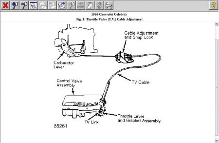

My problem seems that the trans upshifts to soon, at low speeds. It's into 2nd by 15 - 20 mph. Then it wants to jump in and out of 2nd to 3rd and back. It also (sometimes) won't go into 3rd on the highway when it's cold. It also downshifts into 1st hard when stopping. I tried the Throttle Valve cable adjustment steps and it seems to work, but then reverted back to the same symtoms as before. The TV adjustment said to depress the D shaped button and move the cable to the stop, but didn't say to move it up or down. I pulled it up and the cable covering came out of the holder. I put it back and did the WOT and heard 1 click. I am not sure if I am doing the adjustment proper.
Thanks.

Recheck your adjustment see below
https://images.2carpros.com/forum/automotive_pictures/12900_throttle_valve_adjustment_1.jpg
https://images.2carpros.com/forum/automotive_pictures/12900_TV_1.jpg

Thanks.[/quote:797188db6a]replace cable if old then adjust the cable the wires frey internaly causing cable to stick
Dec 17, 2007 at 11:06 PM
Suggested Repair
Recheck the throttle valve cable adjustment. If the cable is old, replace it because internal wires can fray and cause it to stick, then readjust the new cable.
