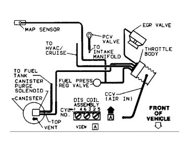

Where is the pcv valve located on a 1989 Chevy Celebrity Wagon 2.8 liter?
Sep 17, 2008 at 6:01 PM
2CARPRO JACK
  • 11,533 POSTS
Should be in the valve cover that is closest to the firewall
