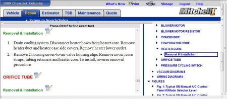

The heater core is where the heater hoses are connected
https://images.2carpros.com/forum/automotive_pictures/12900_heater_core_4.jpg
