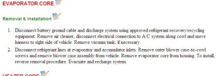

how can i replace the complete evoprator from my car, is it open from inside the car or from the engine cabine? please help me to solve this problem.

hopefully these instructions can come through....
https://images.2carpros.com/forum/automotive_pictures/406719_evap_removal_1.jpg
