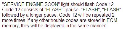

THE ENGINE LIGHT IS ON HOW DO YOU CHECK THE ENGINE LIGHT CODES AND NEED THE ERROR LIST SND HOW TO CORRECT

You place a jumper wire between the A & B terminals of the datalink connector. Turn the key just till the dash lites come on, no further. The check engine lite starts flashing, you count the flashes to get the codes.
https://images.2carpros.com/forum/automotive_pictures/170934_89_checy_celeb_code_1.jpg
