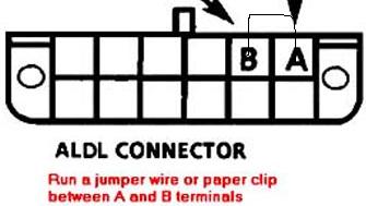

Your obd1, you don't need a code reader. You can use a jumper wire between the A&B terminals at the data link connector, then turn on the key, no crank, just turn the key till the dash lites come on. The mil should start flashing, you count the flashes to get the codes.
https://images.2carpros.com/forum/automotive_pictures/170934_aldl_2.jpg

TDOG1211
as it turns out the fuel pump is going out..what a pain in the butt.you have been very helpful and i thank you for your time replying back to my problem..thanks again..keep up the good work.
