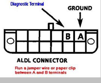

RODAN99
Chevrolet Celebrity 1986 2.8 liter Fuel Injected, 57,000 miles. One owner.
I've been having a problem with the engine cutting out, missing, on occasion. It doesn't do it all the time.
What I have done to correct it: I replaced spark plugs, AC Delco, distributor cap and rotor, sparkplug wires, fuel filter. I checked the fuel pump with a fuel pressure checker, checked out ok.
I pretty much just lived with the problem. I only drive the car about 15 miles, every day, weekdays.
Now, more recently, the "service engine soon" yellow indicator panel light comes on when engine is started, and stays on. Just been doing this for last few days.
Now here's the puzzlement, the engine runs fine now! No stalling or missing, no cutting out. Engine runs as smooth as it did a couple of years ago.
What should I do next? Is there a way to check the codes, ( this is a 1986 model ) like you can on the newer cars. IF so, where is the connector located, and, what is it called ( newer ones called OSBD2, i think)
Apr 11, 2018 at 12:25 PM (Merged)
  • 110,240 POSTS
You have the OBD 1 set up. With a jumper wire, jump A and B. Turn key on (don't start engine) and count the flashes from the check engine light. Each code is a 2 digit number. Let me know what you find.
