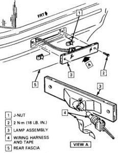

I need to replace a rear turn signal bulb, but I don't see any way to get to it. Can you help me?

Rear Turn Signal, Brake and Parking Lights Remove the tail light assembly screws, then the assembly. Disconnect the twist lock socket from the lens housing. To remove the bulb, turn the twist lock socket (at the rear of the housing) counterclockwise1/4turn, then remove the socket with the bulb; replace the bulb if defective.
