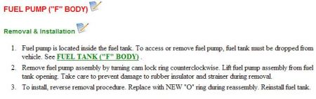

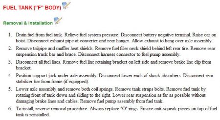

How do you remove the fuel pump?
Sep 13, 2009 at 11:36 AM
BLUELIGHTNIN6
  • 16,542 POSTS
Hello and thanks for the donation! Below are the proper replacement procedures for your vehicle's fuel pump...
https://images.2carpros.com/forum/automotive_pictures/261618_Noname_952.jpg
https://images.2carpros.com/forum/automotive_pictures/261618_Noname2_260.jpg
