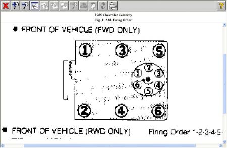

1985 Chevy Celebrity 6 cyl Two Wheel Drive Automatic
I was replaceing my spark plug wires and didnt know that i should have done one at a time. Is there something i can look at or if you could tell me which wires go where id appreciate it

See below and you have a nice day we all make mistake at times-Good Luck
https://images.2carpros.com/forum/automotive_pictures/12900_fo_8.jpg
