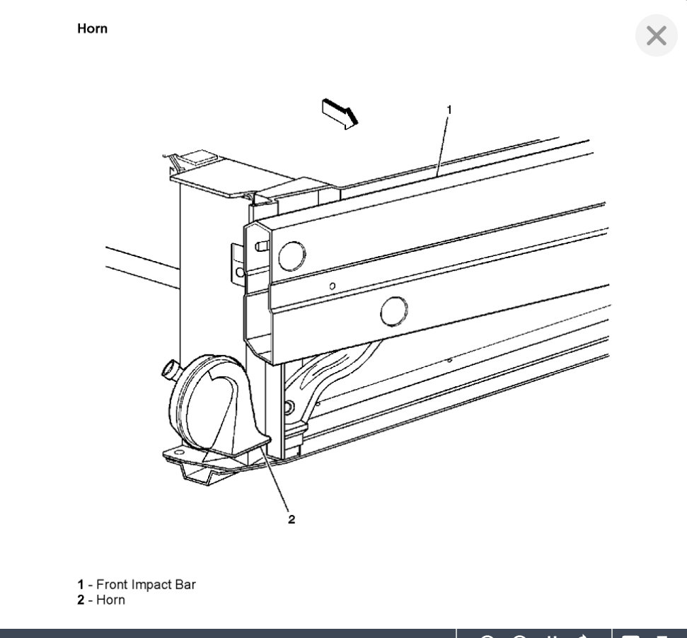

What is the location of the horn on a 2005 chevy cavalier? The cavalier has a 2.2 L ecotech engine with 38,000 miles.
Oct 24, 2007 at 11:10 AM
The horn on this vehicle is located on the passenger side and next to the front impact bar.

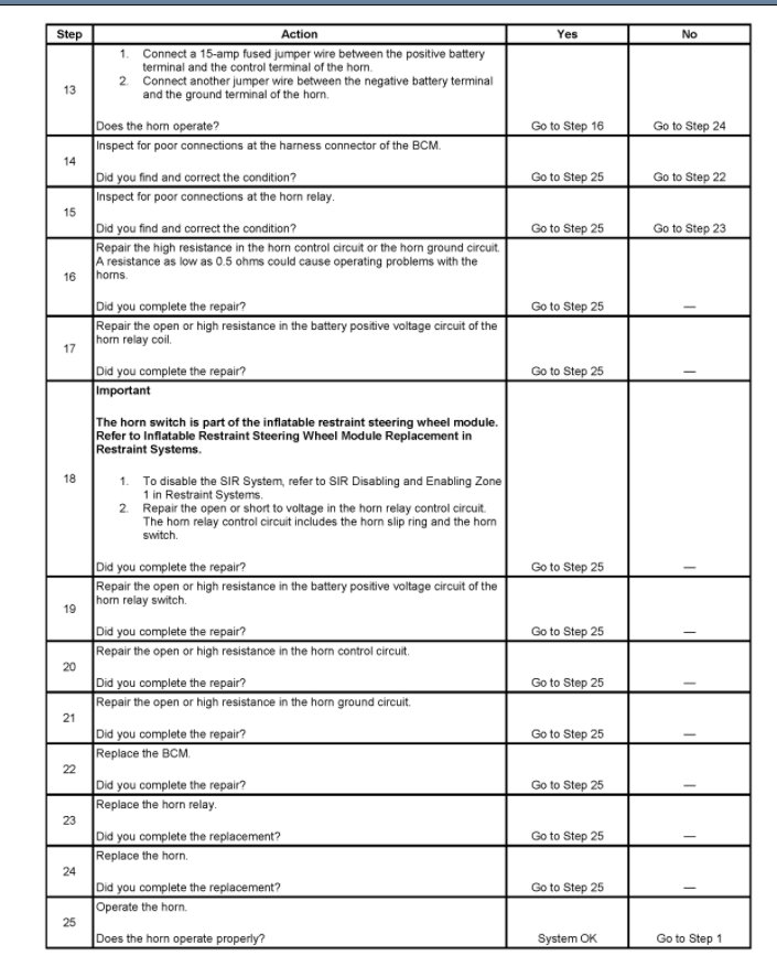

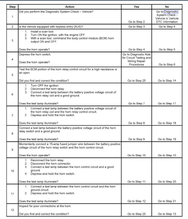

I assume that the issue is the horn is not working. So here is a guide that will help with the testing that I am attaching as well as the location of the horn.
Please see the attached below for the detail on how to test the horn and where it is.
