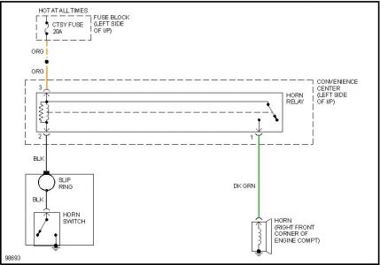

Where would I connect the horn on this car?
1991 CHEVROLET CAVALIER
80,000 MILES • 4 CYL • 2WD • AUTOMATIC
DETAVIUS1
Where would i connect the horn on this car?
Feb 18, 2010 at 8:32 AM
BLUELIGHTNIN6
  • 16,542 POSTS
not sure what you are asking , but your vehicle's horn is located in the right front corner of the engine compartment. wiring diagram is below..
