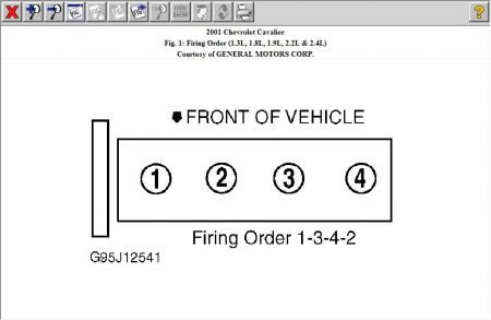

Have a 2001 chevy cav. 2.2 liter. Replaced spark plugs and spark plug wires. At first put two of the wires in incorrect order. All four wires are now incorrect order, but the car wont start. How can I correct the problem?

See below and Good Luck Happy Hoildays
https://www.2carpros.com/forum/automotive_pictures/12900_firing_order_1.jpg
