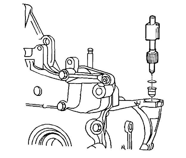

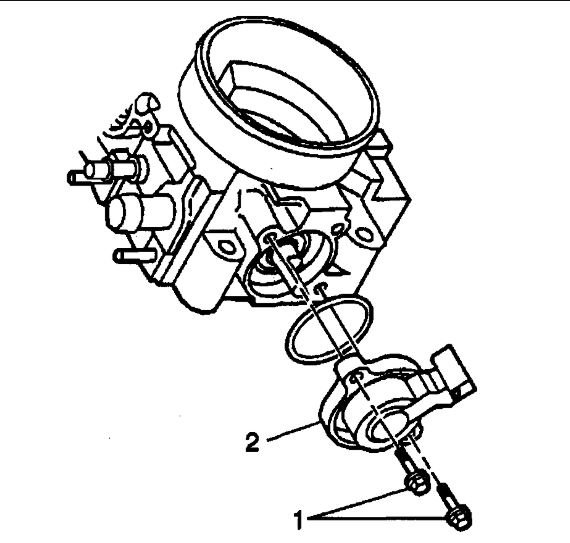

Good evening,
As far as the transmission, the shifting depends on the 2 sensors. One is the TPS or throttle position sensor and the other is the governor.
If you have a code reader, I would love to know if there are any codes set.
The engine may be topping out from the non shifting issue.

Suggested Repair
Scan for diagnostic trouble codes. Check the throttle position sensor and transmission governor, which control shifting. The engine may be reaching its limit because the transmission is not shifting.
