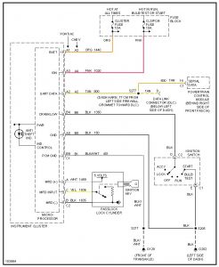

Hi, I am a Lcoksmith and we are having issues with a Cavalier (re-badged as a Toyota in New Zealand) the car had a damaged ignition switch, we had to die grind the locking pin to remove barrel, once barrel was out we sourced another barrel, rekeyed to the original key etc...then we found a small magnet like transponder device in the inner barrel and a receiver device on the barrel housing, I tried to remove the small magnet however it was damaged (very brittle and probably not made to be removed).
The small piece of magnet became very fragmented but I was able to get it into the new barrel, however the theft system is enabled and will not allow the car to start (car will start for 2 or 3 seconds and then stop)
Any suggestions? can these be bypassed?

I believe it can be by-passed. Our shop has done it in the past by disconnecting a wire. The only problem was that the anti-theft light was always on. Not sure how it was done, but here is a diagram of the system.
https://images.2carpros.com/forum/automotive_pictures/30961_cav_1.jpg
