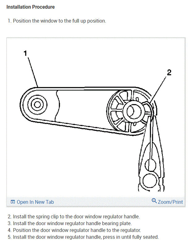

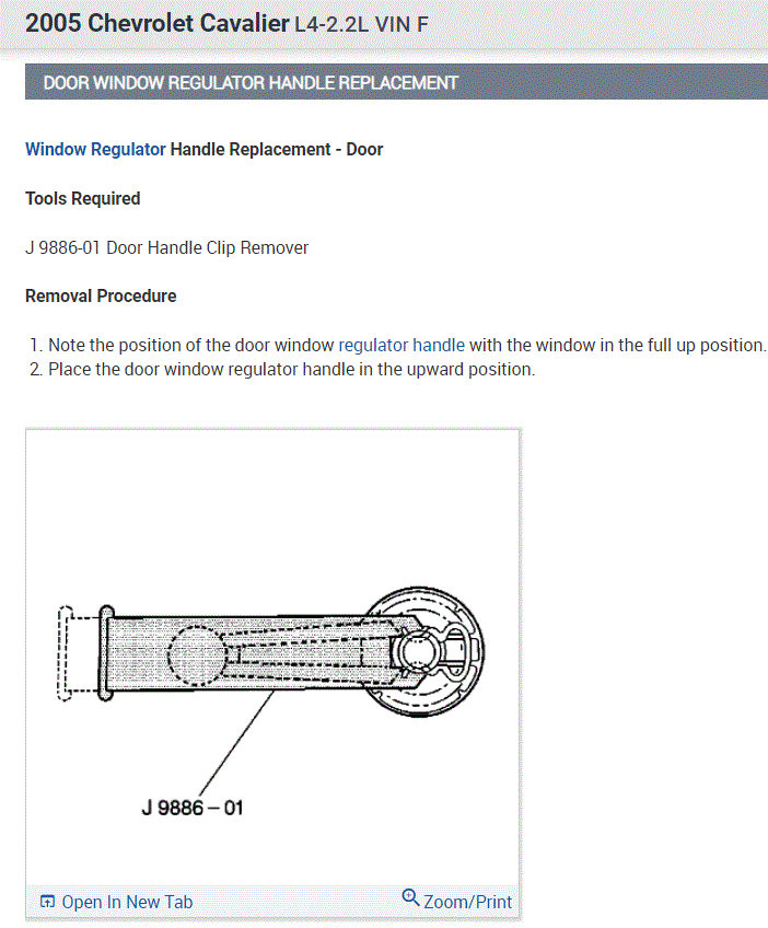

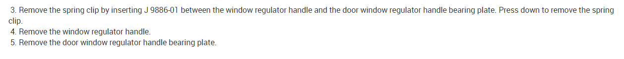

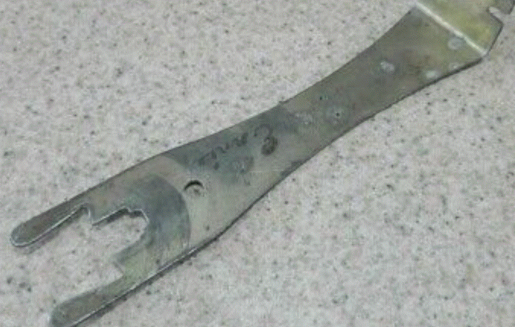

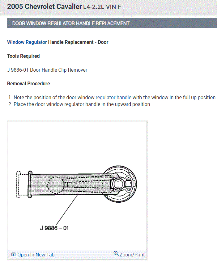

They can be difficult to remove without the right tool. There is a spring clip behind the handle holding it in place. If you look at the first 3 pics below, it explains how to remove it.
The last picture shows the tool that is used. I'm not sure if you were able to get this removed, but here is a quick video that shows it being done.
https://youtu.be/6VRv9TNrxVY
I hope this helps. See pics below. Joe
