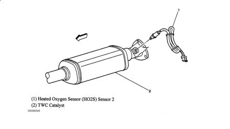

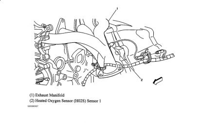

I was wanting to know where the oxygen censers or in my car. My engine light was on and we are thinking that is the problem. Can't find the book to my car anywhere.

You need to have trouble codes, checked. Some of the national brand autostores used to check some codes for free. As far as the 02 sensors, should be two, one before the cat, the other, after.
https://images.2carpros.com/forum/automotive_pictures/512072_cavalier_the_cat_1.jpg
https://images.2carpros.com/forum/automotive_pictures/512072_cavalier_after_the_cat_1.jpg
